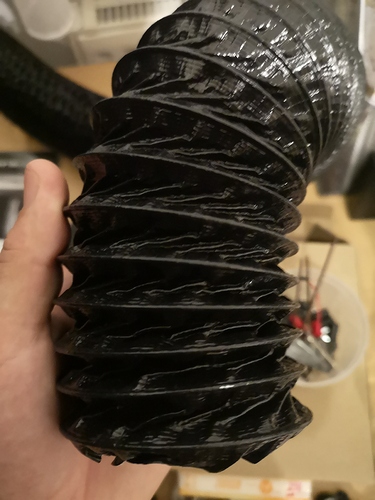

Still waiting for my A350 to arrive but prepping the space where I will use it. I am looking to pass the duct through a plexiglass window replacement to vent to the outside. I will need to cut a hole in the plexiglass to accommodate the duct. Does anyone know the diameter of the exhaust duct?
It’s about 88mm, but I would suggest you to drill or cut the hole when you have the machine because maybe you could drill a less big hole and turn the tube out. Because of the spiral thing, here is a pic
