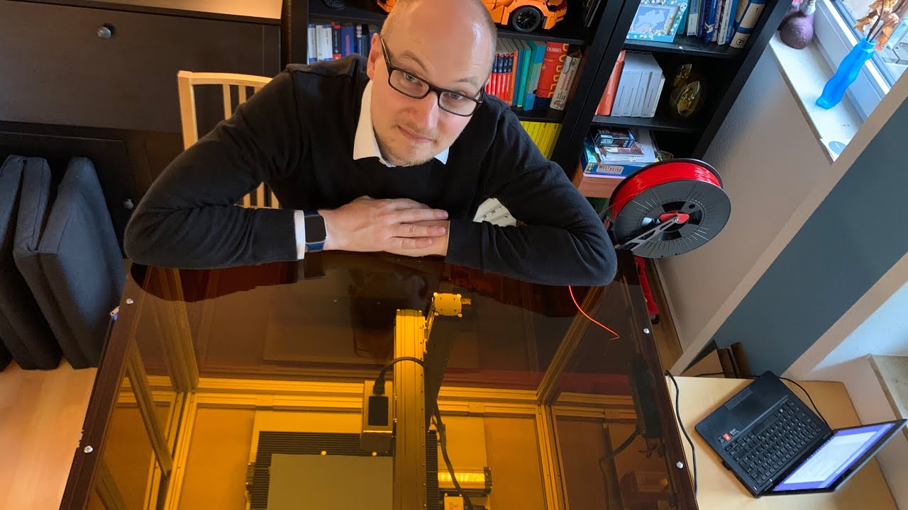

The quality of the enclosure (I have one for my A250) is impressing but there are a few design errors.
Is there a way to use the enclosure with the doors on the other side?
I just assembled my enclosure - tried it - and in my opinion you can’t do without modifications.
So I can’t really use the enclosure right now (filament holder on the wrong side.
The front door is not the problem (you can rotate the one door sheet for the display and the 4 rails on the frontside) but the design of the long rails (along Y-axis) are.
Since the acrylic sheets are screwed over the rails I don’t understand why they didn’t make it possible to change the sides. Or 4 small M2,5-holes so the LED stripes can be mounted to the bottom rails and cut-outs for the feet holder on the top rails if this is cheaper.
Maybe ther is a posibility right now but I don’t see it.
And if not the Snapmaker team should offer a conversion set containing just 2 side rails so you can mount the side door on the left and maybe a USB-C extension for the display.

Just got my enclosure and assembled it yesterday. So I do not have much experience with it yet, but wanted to share my initial feedback. Keep in mind this is all based on the A350 version.
Assembly:
  1. Overall it went rather well. All pieces were in perfect condition although I will say there were an excessive number of the door sliders (needs 4, mine came with 10) which made me keep checking if I somehow missed some. There were also excess bolts, but only a couple per type so more along the lines of “reasonable spares”.
  2. The frame assembled picture (Step 10) was very useful and helped me find some errors I frustratingly made, despite all the help at the steps I had messed up.
  3. Fit of pieces seems pretty decent. While there are some fairly minor gaps at corners of the plastic and such (excluding the decent size gap around the touchscreen) everything is pretty stable and solid.
  4. The only “broken” part I would somewhat claim are the magnets on the door handle areas. 3 have already come unstuck and needed to be reattached, so I think their adhesive tape needs a bit of work.
