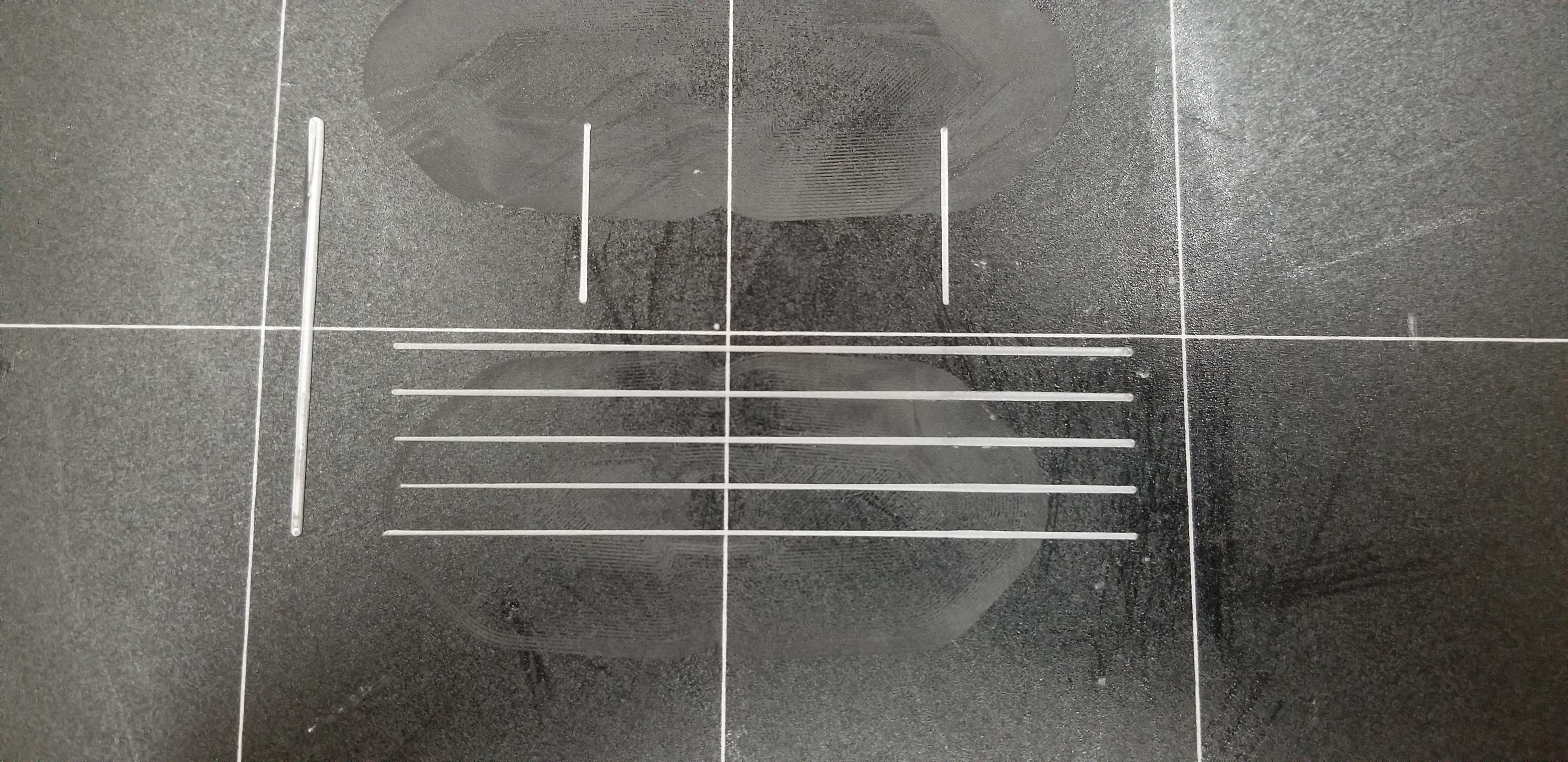

Shown in the image below the same lines but all printed using the same M900 K value (0.08). This was done by manually setting the M900 K value through the console in Luban and printing over a USB connection from a PC.
As you can see, the printed line quality shown is much different to the K0.08 line shown in the image from my previous post which suggests that the K900 command in the g-code file used to print the previous test was ignored.
Please can this be investigated properly as solving this issue would make tuning printer settings for different materials far less hassle as at the moment it requires manual changing through the console and re-printing per M900 K value tested.

The point of this script is to dial in the M900 value though so putting a single value in the start script wouldnt help unfortunately. Im not even entirely certain putting it in the start script would do anything as it seems to ignore all the other M900 commands as well.
The only time M900 seems to work is when entering it into the console over a wired connection and saving it to the printer settings using M500.
I’m willing to bet that the script will work from Octoprint by bypassing the touchscreen. The touchscreen seems to have a few issues when it parses the gcode files. I will try to run the script tomorrow and let you know.

Sorry for late response, while I was unable to reproduce the issue, I postponed it and I started learning firmware as well to reproduce issues you mentioned.
As I mentioned above, we didn’t modify the M900 command (I didn’t even use M900 before reading the topic).
After a few tries, I realized that why you failed to set K factor is that you were using the G-code generated on Marlin website. Commands with specific comment could be ignored by the firmware.
The line that sets K factor as below, these are two "K"s in the line which cause the G-code parser unable to parse the value (1.6) correctly.
M900 K1.6 ; set K-factor
If you change the comment to lower case, it will work as expected.
M900 K1.6 ; set k-factor
