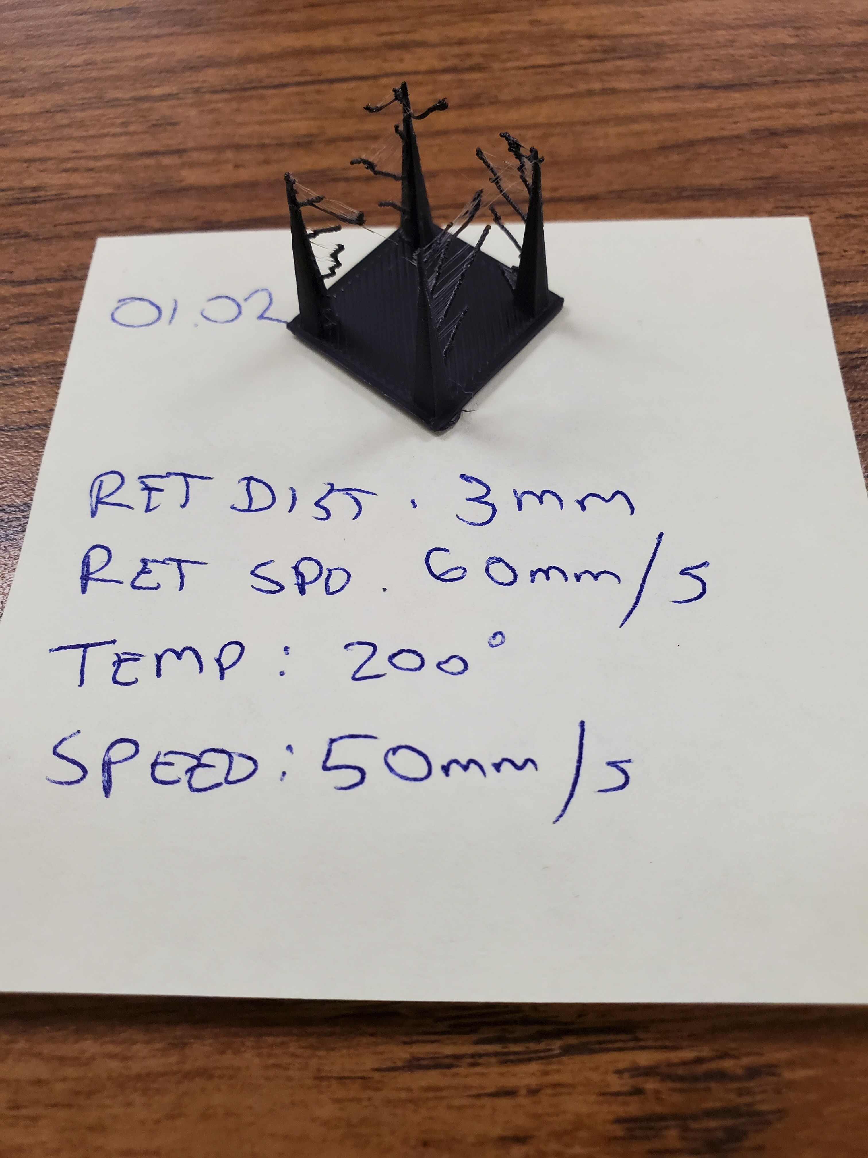

Howdy, folks. I purchased a SM 2.0 for my classroom, and am currently in the process of learning how to use it so I can teach my students about rapid prototyping.
Currently, I’m using Luban on a W10 machine. I’m using the latest firmware build (upgraded it, this week). I have am organizing my sample builds, starting with temperature variants, and these are my results so far:
As you can see, I’ve got a lot of very solid strings going. One of the first things I did was change the default retraction speed (after the first print model was a tangled mess), but I was wondering what I should start modifying from here, to get a better result?

I’m using the default spool of PLA that came with the machine. I’ll definitely back off my 3mm retraction distance. As for the PLA, I got a single good print of several objects at once, but after I updated the firmware, everything went higgledy piggledy, again. I’m guessing due to the extraction error correction in the latest build, which is why I’m starting from scratch.

I’ve been sharing the test results with the students, and we’ve been talking about them in relationship to what we known about the process. We’re also printing out a small 15mm miniature, for comparison purposes, with each tower we’ve printed (see below). What test would you recommend for just retraction issues?
Here are the GCode Files for the various tests I’ve been running. Test_01_01 and Test 03_01 are retraction test towers, and the 01_02 and 03_02 are small game figures. I’ve run them both at 190, 195, 200, and 205 degree, using:
  • 60mm/s travel speed
  • 1mm Retraction distance
  • 60mm/s Retraction speed.
The best result I’ve gotten at this point, using the Snapmaker PLA included with the machine is below. As you can see, I’ve moved from solid threads to a few smaller threads and lots of fine webbing, so I guess that’s a bit of improvement:

I’m did some tests of this one this morning. I ran them at 190, 195, 200, and 205, with the Snapmaker PLA (unfortunately, that’s all I have, at the moment, having shot my budget on the machine and enclosure). I’ve set the retraction parameters for:
1mm Retraction
60mm/s Retraction Speed
0 Extra Restart
40mm Prime Speed
0.5 Z-Hop
All the resulting temps had ‘hairy legs,’ to some degree, but really, there was little real difference between the various temperature ranges. Pretty much all of them came out looking like this:
So it’s clear from this particular test (thanks, Brent) that retraction isn’t really my issue. So I’m kind of stuck at why I can’t get a relatively clean print on my other models (like the ones below) using the same retraction settings. Is there something else in this GCode that I’m missing?
