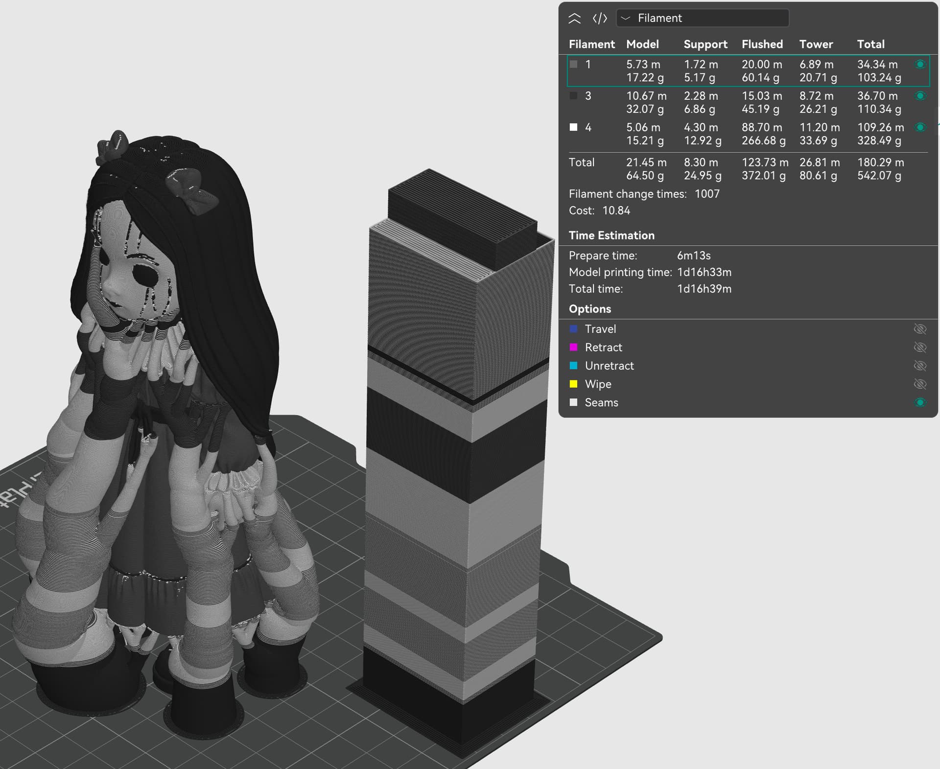

Process info: 0.16 mm, 15% adaptive cubic, 15mmX15mm prime tower (35x35 for the more conservative approach), tree supports
1st try, as suggested by the A1 mini default settings:
The waste is 7 times the actual object.

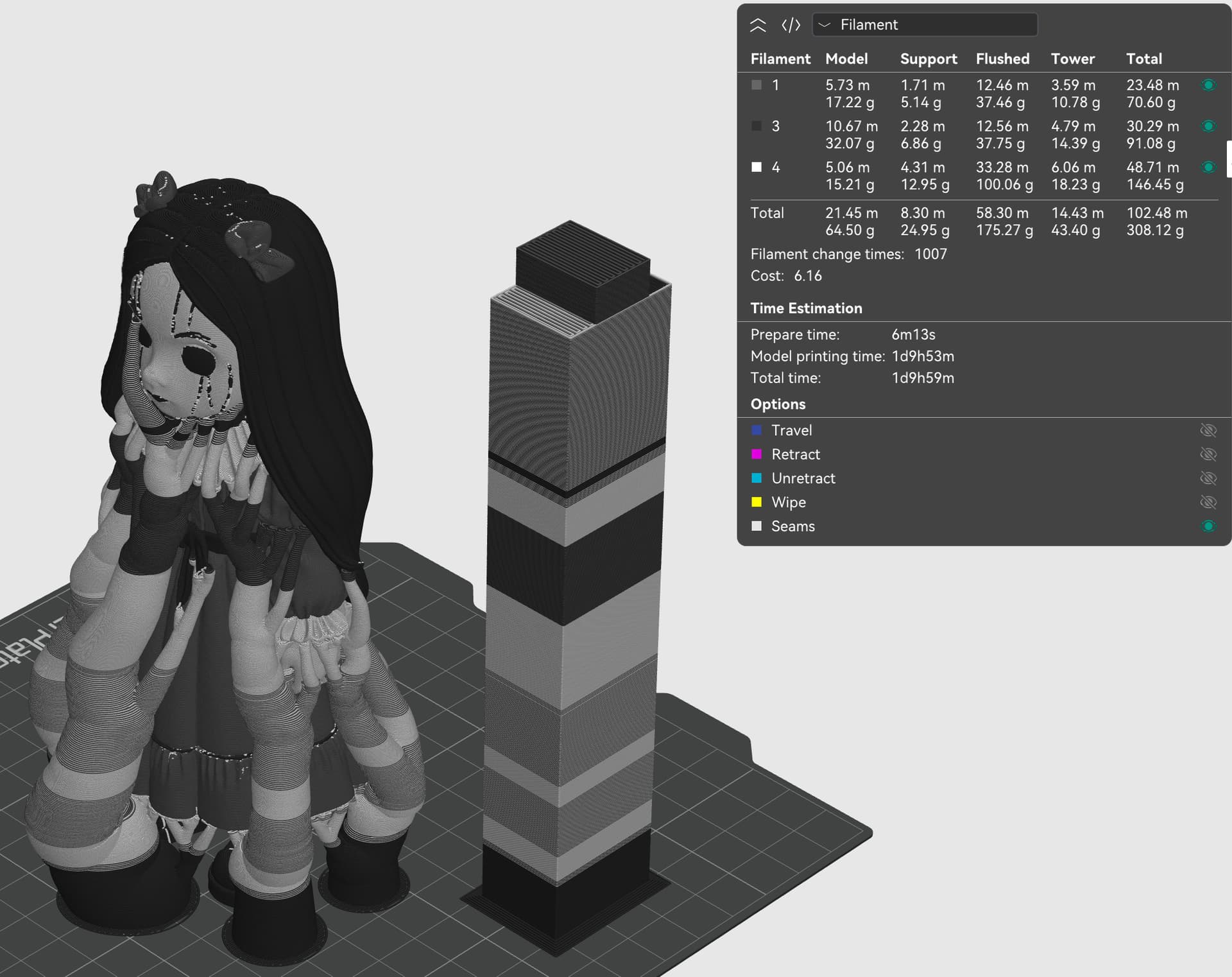

But we all know that those defaults are vastly “conservative” (wasteful), so here’s a more sensible approach for the 2nd try:
And we almost halve the waste with a 3.7 times the object weight in garbage.

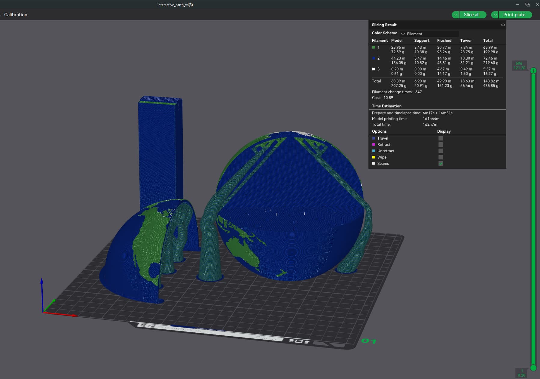

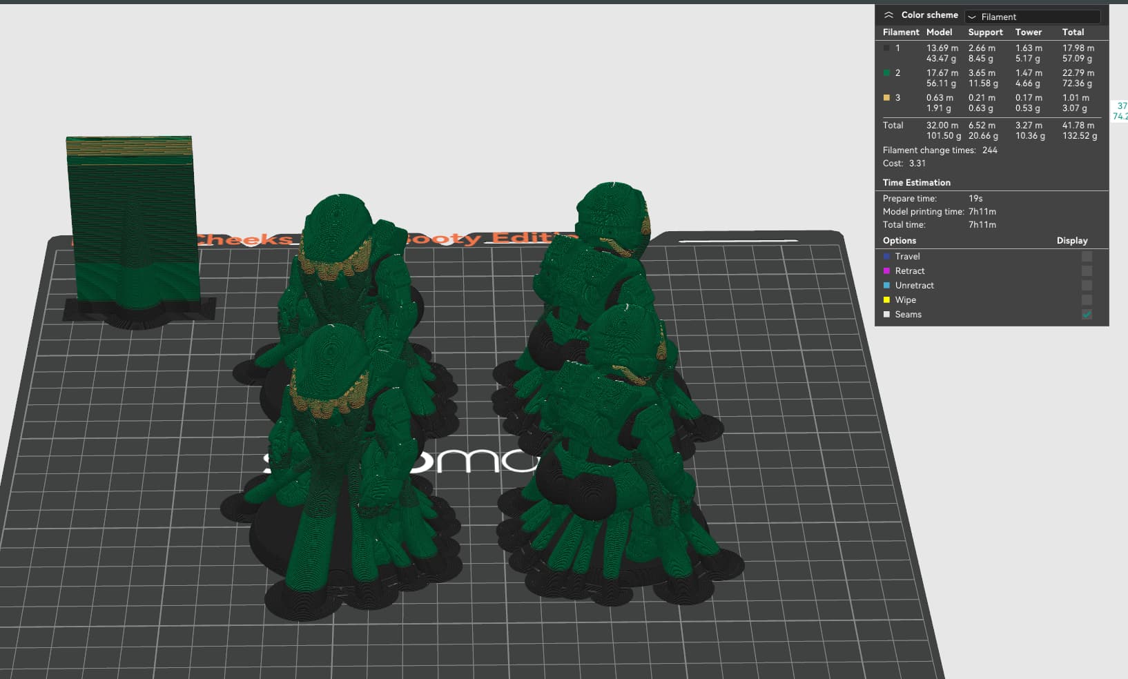

whilst Master Cheeks will likely be printed at some point my daughter has expressed an interest in me printing this for her school. it is a cutout of the globe with all the different layers present and attaches together magnetically
https://makerworld.com/en/models/1120507-interactive-earth-model-with-layers#profileId-1118807
here is the main preview on the A1, i have collated the pieces together a bit better than in the original 3mf as there were 2/3 extra plates and this is how i would print it on the A1
on the A1 the globe on its own will take 26 hours and use 435g of filament
on the U1 the globe and inner core take 14 hours and use 379g.
The enitre print on the A1 will take 1 day and 6 hours and use 536g
The same print on the U1 will take 18 hours and use 512.31g.
Here is how i organised the plates for the U1
i appreciate that the savings arent massive as it isn’t a huge mulitcoloured print, but the time difference is noticeable. this is without being able to do any volumetric tweaks to the U1 which could further reduce the overall time
