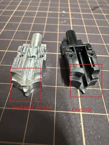

Hi everyone,
Coming from a mechanical automation engineering background, I’ve been analyzing the extrusion path on the Snapmaker U1. After a rigorous 4-week field test involving heavy multi-nozzle and multi-color printing, I identified a specific area for improvement: the precision of filament guidance into the gears.
While the stock components work, frequent retractions and long-term use can lead to slight path deviations, which increases the risk of filament buckling or jamming. To address this, I developed a Precision CNC Aluminum Extruder Guide .
Technical Highlights:
Precision Guidance: The internal geometry is meticulously calculated to match the OEM gear specs, ensuring the filament is guided perfectly into the teeth.
Anti-Jam Design: By stabilizing the path, it significantly reduces the chances of jams during complex multi-material prints.
Ultra-Lightweight (5.8g): CNC-machined from aluminum, it maintains high rigidity without adding unnecessary inertia to the toolhead.
OEM Validation: Interestingly, the newest batch of U1 units I received this week features a factory design update very similar to this optimization, which confirms the necessity of this path refinement.
Note for Owners: If your U1 was purchased after May 2026, please check your current factory guide first, as it might already have the updated design.
I’ve produced a limited pilot run of 100 units for the community. I stand 100% behind the functional performance of this part.

  • Old: Gap allows filament to poke out and jam.
Where do you find the factory guide? Those look nice!
Hi ryallm ~ I would love to continue production, but the current Minimum Order Quantity for CNC parts is 100 units per batch. Although the factory has updated their design, theirs is just a simple cover plate and lacks the progressive lead-in design of my version.
I’ve received feedback that the CNC parts are a bit pricey, so I’m currently exploring more cost-effective manufacturing methods. I am also redesigning the part to be 3D printed with PA6-CF . I’m ensuring the design allows layer lines to be polished with specialized tools, so the surface remains perfectly smooth and won’t affect the feeding process.

Oliver, after carefully evaluating the current hardware situation, I’ve determined this is an unwinnable battle:
  • Path Disruption: A massive 1-2mm gap exists between the feed tube and the hot end, which is fatal for the 60A.
  • Tension Control Issues: The extruder’s tension springs are too stiff and non-linear, preventing precise pressure adjustments for ultra-soft materials. With the 60A, we need surgical precision, but the current tension structure is more like a sledgehammer.
  • Deformation Management: The powerful springs directly flatten the 60A filament, and combined with the 0.3mm gap, the filament almost always collapses before entering the printhead.
  • Conclusion: To reliably print the 60A, we need more than just a guide; we must replace the spring system and redesign the entire hot end path. This goes beyond a development kit; it requires a complete overhaul of the machine. Given development costs and space constraints, I believe this is not feasible.
You hit the nail on the head with the ‘toddler in an antique shop’ analogy. That’s exactly why a simple 4mm ID straight tube is a gamble.
My design is fundamentally different because it uses a Progressive Tapering strategy.
In my solution, I don’t just ‘stop’ the 4mm ID; I transition it. Instead of an abrupt jump from the loose 4mm ID to the tight extruder inlet, my component acts as a dynamic funnel. It gradually narrows the space, ‘herding’ the filament toward the center of the path long before it reaches the critical gear engagement zone.
Why this is superior to a straight tube:
  1. Zero-Collision Loading: A straight tube allows the filament to ‘snake’ and hit the entry shoulder. My tapered path eliminates those sharp edges, ensuring the tip always slides into the 2mm zone.
  2. Controlled Freedom: We keep the low-friction benefit of the 6mm/4mm PTFE for the long run, but provide Sequential Constraint at the entry. It’s the difference between a cliff (Stock) and a smooth ramp (My design).
  3. Reduced Buckling: By centering the filament early, we ensure that when the gears push, the force is vector-aligned with the hotend path, reducing the chance of the filament bowing sideways inside the extruder.
In short: A straight tube leaves the filament to chance; my design uses geometry to force a reliable outcome.

Hey Ethan:
I really appreciate your detailed and prompt reply.
Just a couple tidbits from our side:
We successfully loaded and printed 60A on a Snapmaker in it’s standard form, just loosened the tension on the extruder gears quite a bit. We printed for about 20 layers before experiencing an extruder jam which saw the filament buckle between the bottom of the gears and the filament path.
So it is possible to print the 60A and I imagine its not as impossible as you might think given our minor success.
We actually reliably print 60A on Elegoo 3 printers. They have a very short filament path and a more constained filament path, but it’s nothing special. It also uses the same spring loaded gear system with similar sized extruder gears.
I recognize the use case is small, but 60A filament is extremely durable and useful for applications in footwear (that’s what we do). So I think it might have a larger market than you think.
That being said we are capable of designing this part in house too. So if you’re not interested we will pursue our own 3D printed design. The part that needs redesign is the photo I attached below. Not sure what the exact name is for that part.
