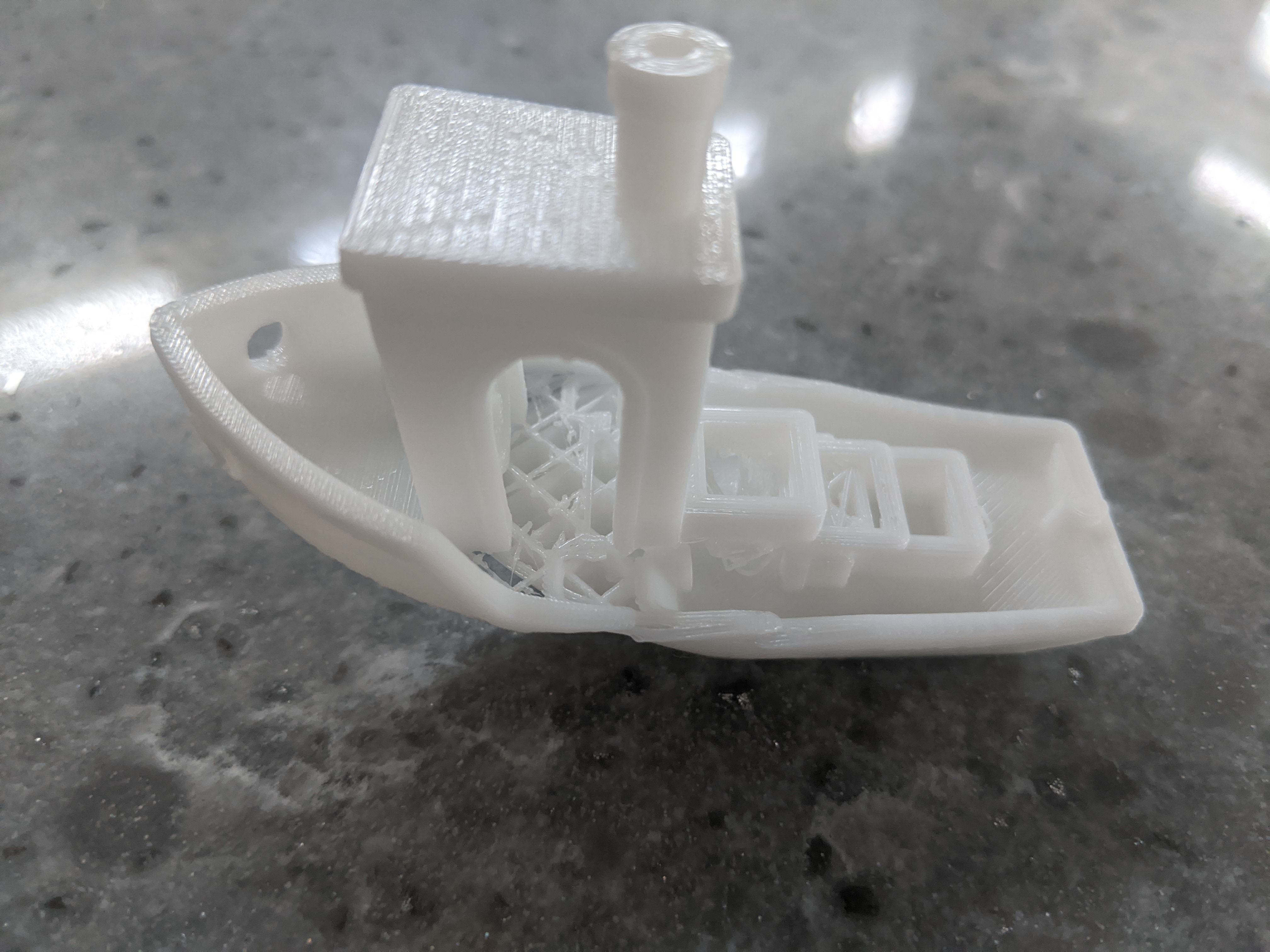

Tried again with luban, printed off a bench, not perfect but worked ok.
Had a few random bits of filament sticking out here and there
Freenspan’s weren’t very good, bit rough
Bottom text wasn’t great either.
Is it just a case of tweaking settings? And trying again?
I wasn’t getting the random axis shifts though this time, I did apply latest firmware so that might have helped.

I have both Snapmaker Orgininal & Snapmaker 2.0. 2.0 prints great, original has given me a shift every time as well. Although it is not consistent, sometimes it is in the X, other times it’s been in the Y, but never both. I’m wondering if it might have to do with the models being rotated to get them flat on the table.
Update: I added a z-hop of .05mm and have not had a problem since doing that. This confirms what I read in another thread that the print head was more than likely hitting the print and causing the step motors to lose count.
I think that can help, but my issue was one of the linear motors overheated and turning off about 20 minutes into use. I couldn’t see it until I switch the problem motor out with the left to right (x motion) because it was working by itself. The y and z axis have to motor. So it would work for the most part until it would get jammed. They are sending a replacement linear and I will see how it does.
