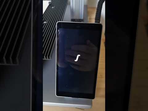

I am working on this and will offer the solution later. Thank you for your files. Can you send me some pictures of this issue?
I actually have video of the issue, these two videos are from after triggering the resume on power failure, and a second attempt at triggering the resume on power failure.
Beyond that I just had the same print stop, but this time job was sent over terminal via Octoprint. Looking at the Octoprint logs the terminal connection is just dropped. The print died a few layers earlier this time but the print head stopped in nearly the same spot. It occurs to me I should look at the Snapmaker logs as well, as even though the job was not run from local storage the moves are likely captured by the internal logging.
I will post these tomorrow as it is late and I am over the Snapmaker for tonight.
Thank you for your information and videos. In the email, I told you that we noticed something abnormal and still working on it. I will forward these two videos to our engineers. Sorry for the inconvenience.
