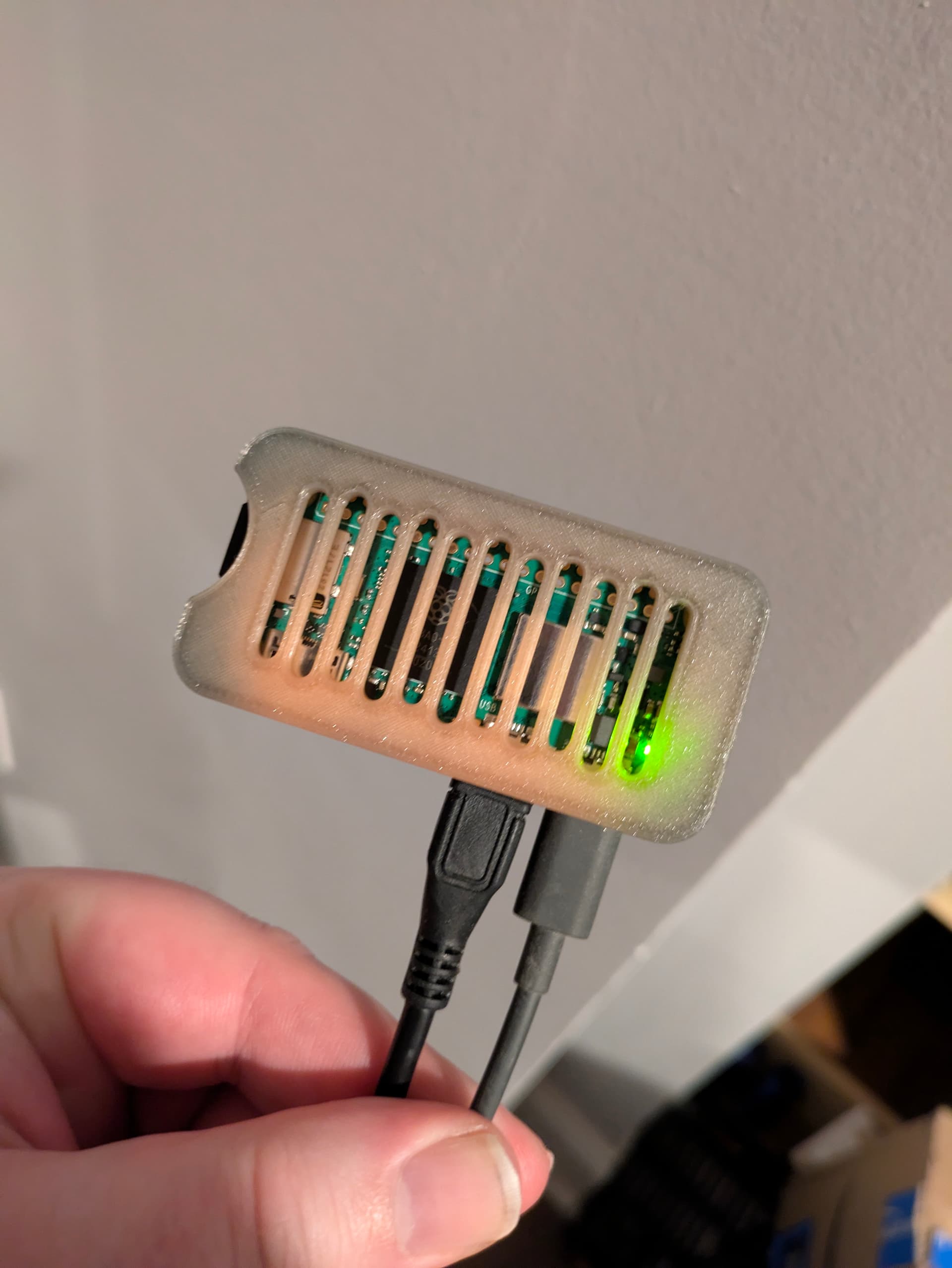

Pi Zero 2W Backpack
Had a spare Pi02W and wondered if I could use it without any external power. Apparently… Yes!
Next step is to make a small modification to the case to add some screw holes to mount it to the Z rail as a self-contained backpack. Which lets me bypass the touchscreen and Luban completely with a more reliable system. :upside_down_face: I also need some shorter cables for better cable management… However, if anyone was wondering, now you know. You can power a Pi02W from the snapmaker USB port and run Octoprint for your gcode sender. Bonus; You can send gcode files generated from Lightburn to it and run directly as well.

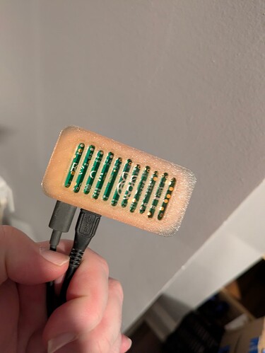

If you want to pre-print it. This is the case I’m currently using:
I plan to modify it to add some mounting screw holes that match the ones on the linear module. Also for the lulz, I used a thermochromic PLA that changes colour with heat. From pine green, to orange, to bright yellow. Helps see waste heat and tell it’s not getting too hot. :upside_down_face:
