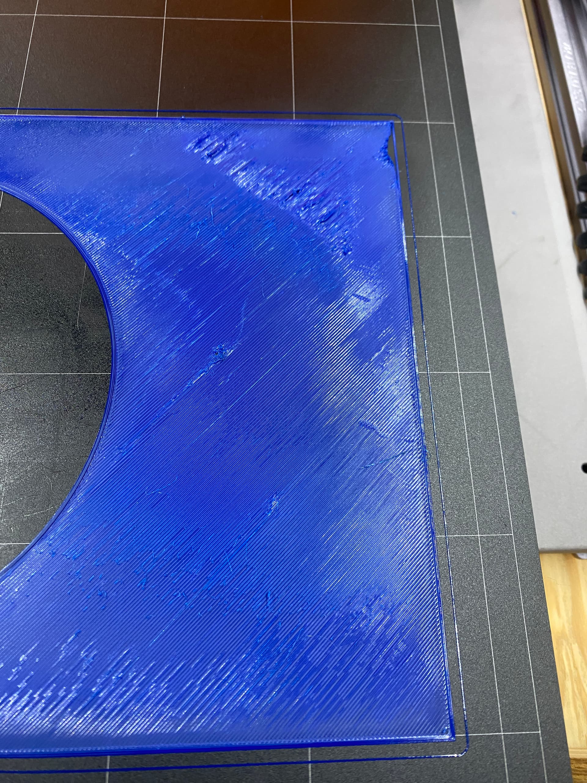

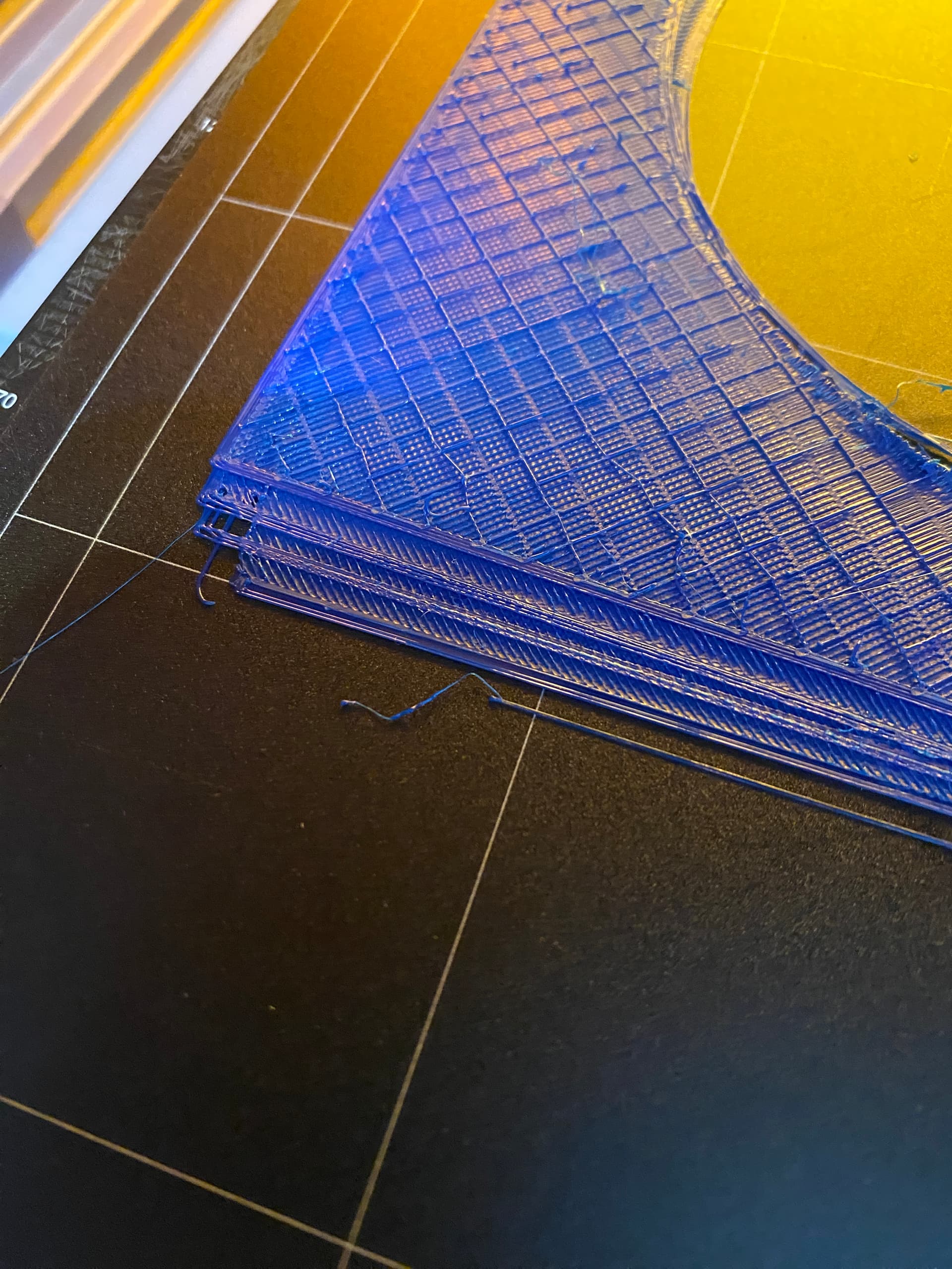

I have been trying to print with PETG on my A350. I have a print that is large in surface area, ~ 200 x 290 mm. Initially the failures were spaghetti balls, starting in first or second layer. I re-leveled and re-calibrated z height, and this last time it was going well until .. it wasn’t. See picture - the nozzle actually pushed the build plate (I’m using standard OEM Snapmaker build plate). I really thought it was going well until I took a closer look and realized what was happening. Maybe of note: Everything I’ve read says PETG wants to stick to the bed. My failed prints have all come up easily. FWIW - I have printed prints of similar xy dimension in both PLA and TPU with no issue. Given the way the layers are misalligned (see photo), to me it seems the bed is getting a one-time push at the end or start of the layer (i.e., edges of the misaligned layers and support structure features are straight).

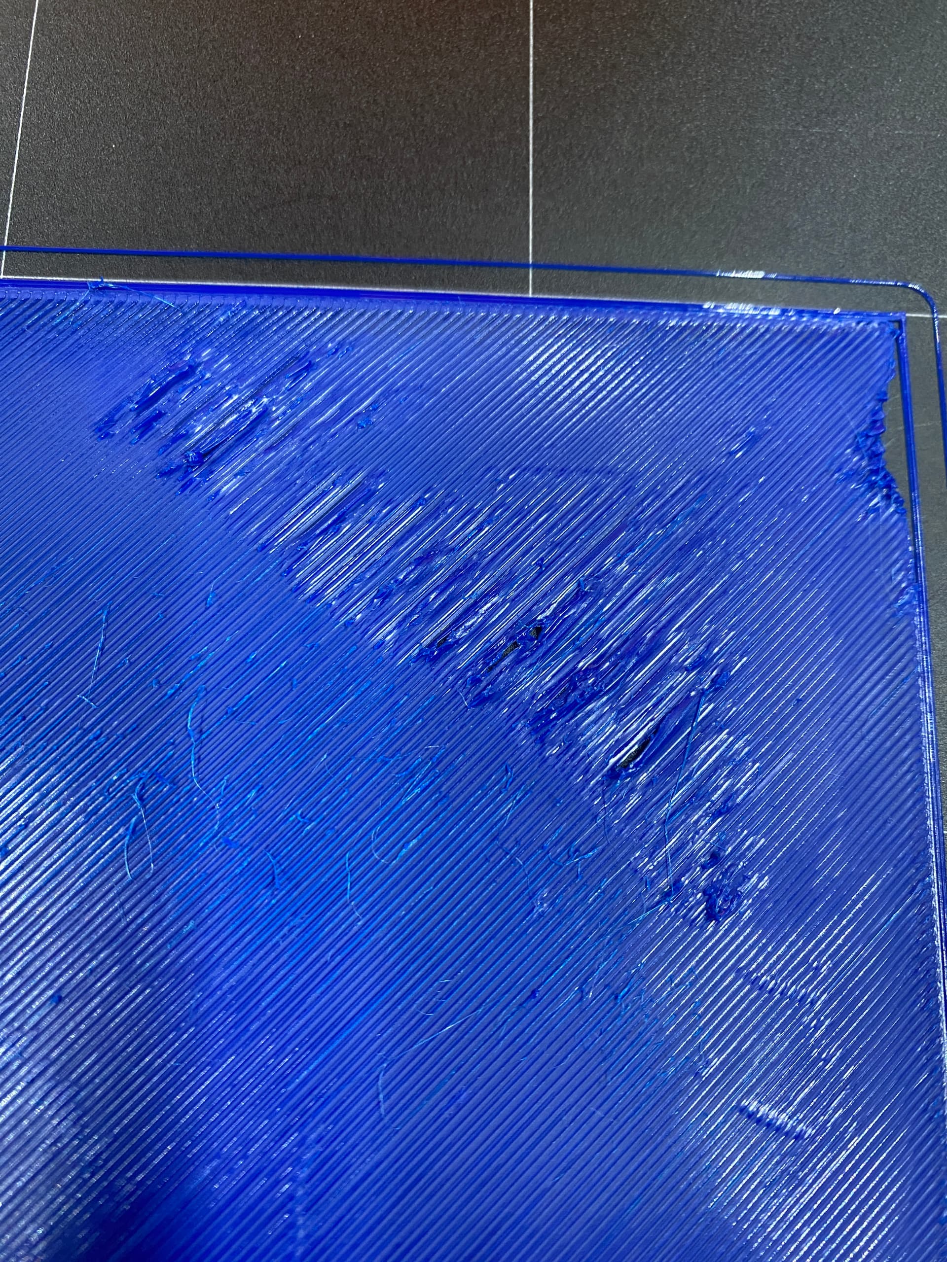

Update: I decided maybe I had the z-height calibration to aggressive (low), so I re-did that, and started the print again. Part way through the first layer it is failing (see picture). It is ok over most of the print, but then in this one area is .. ugly.
Here is the print as I found it on the bed:

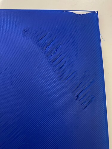

Close-up of the top surface. Those defects are sticking up above the layer - not stuck to the bed.
Here is the back-side of that same area.
I thought maybe it could be bed leveling so I did a manual G1029 bed level with the build plate and nozzle at temperature, and did a 5x5 grid. Re-running the print now but not to hopeful.
You see two issues here I suppose: A) an uneven print bed (many suffer from that) - solution: Pick the tightest bed leveling pattern you can or even go to 11x11 via GCode. More on that here: Bed Leveling - Revisited & Detailed
B) PETG has a tendency to warp, and that may cause the nozzle to catch a warped part of the print and dislodge the print sheet. My solution was this: Magnetic print sheet fixation - #10 by Hauke

Update and OMG. I fabed a bracket to attach a dial indicator to measure bed leveling, and it is BAD. I have about 1.5mm runout, front to back at center of the bed. Side to side is approaching 1mm. I am digging into it, but that would seem to be a smoking gun.
