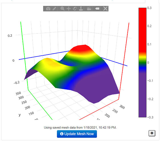

Hello.
what do you think about my bed level?
Thanks
Thats my level status at 60°C - working still to make it better.
Your scale on the chart is not very useful.
@Tone Whats wrong with it?
You can’t see the lower portion. I would have it set for ±.2 mm.
You want to be able to see all the hills and valleys.
I cant follow you, It shows the differenz around 0 over the bed, or what do you missing in the chart?
It looks like it is truncating the lower values. You can’t even see 1/3 of the chart. It would be more useful to have a flatter chart which is what you would get with a different z scale.
Cant verify at the moment, will have a look at it, but my digitalprobe shows nearly the same values.
