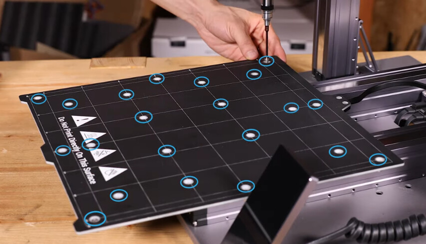

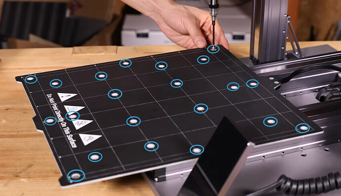

On achieving a perfect level
I adjust the screws mounted to the inserts as instructed in the assembly manual - so the compensation is done by unscrewing those M4x10 screws marked blue on the picture. I try to make those that are on the locations of the bed that are usually sunk to stick up above the surface slightly.
Probably no the perfect method but at least I can get the printouts that were impossible with regular automatic calibration before screw adjustments.
One more hint - I noticed less problems with 3x3 calibraton than with 5x5 which is a bit counter-intuitive.
