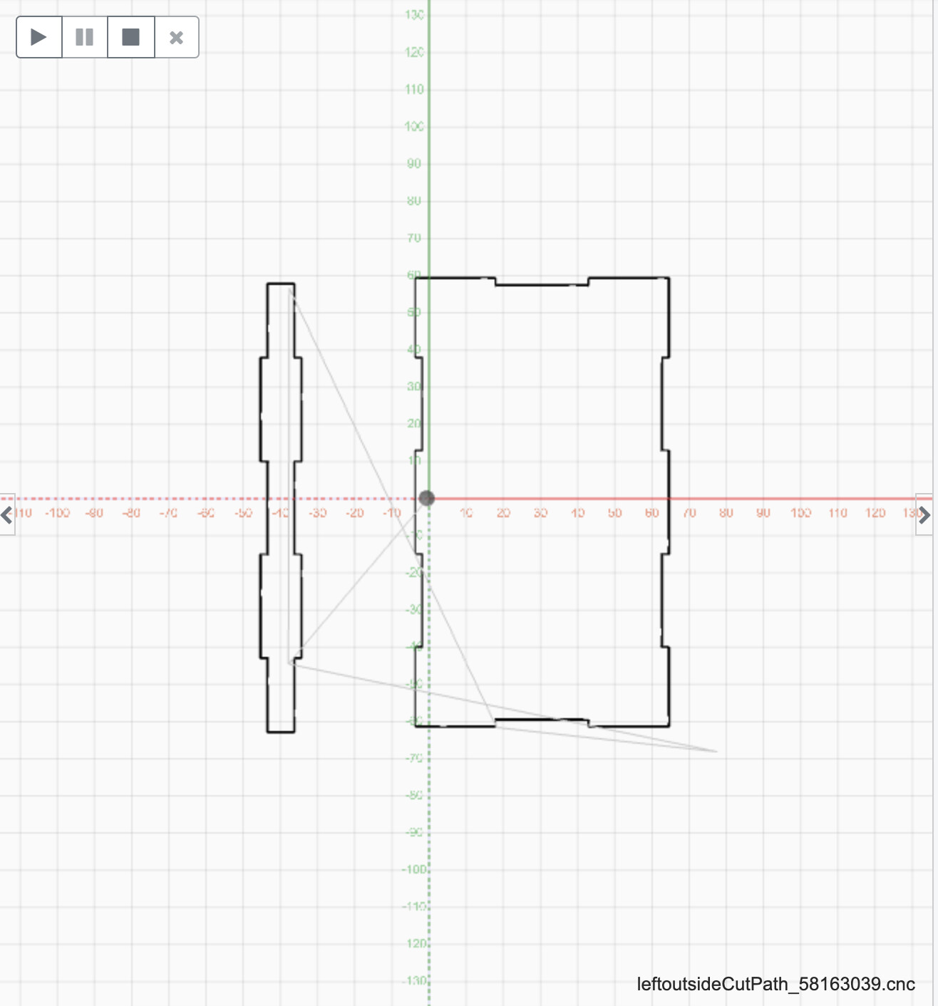

I’m trying to cut a simple box with CNC. Due it’s size I need to CNC it in two pieces. I have 6 objects in total.
I add three in one project and after make the tool paths and load code to workspace one piece disappears.
When editing:
When processing:
When I load code to the work space:
What I’m missing here?

You need to make sure you select the object. To, like you have selected one of these objects twice and generate the G-code twice. So the small one is missing.
It is better to go with the 2.2mm or 2.4mm depth to make sure it cut through the material.
