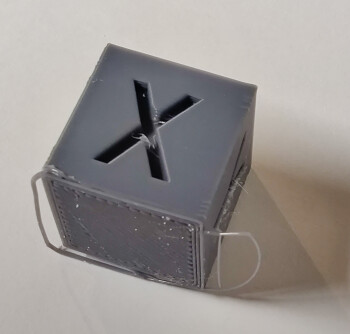

Okay, heres how she came out:
as mentioned the skirt got tangled from lesser priming (or my lack of ability to avoid needing it)
the z gap is gone, so thats a valuable lesson learned - perimeters can cost more than filament and time.
heres some photos, perhaps you will see something
before i took it off the sheet i took a couple, heres the better one
X gon give it to ya
y do i keep doing this to myself
bottoms up
i dont think its too terrible, but i think it definately needs some love.
maybe i should go ahead and try that backlash compensation.
at least it worked!
now i will apply my newly discovered knowledge and return to my over primed mess and reduce perimeters and then go from there. experimenting with more overlap stuff, and im rather curious about the allowed perimeter overlap setting and going to set it to some super high value to see what it does, but only after the 3 perimeter print
baby steps
I think if you look, that was probably with 0.02mm backlash comp. Honestly looks good to me. Probably z height could maybe be 0.025mm closer to the bed for the first layer. Top looks good to me.
I think the settings are in the file, something to reference against.
I will disect the gcode and look into a microadjustment on my z offset, and maybe i should practice my calibration a bit. i did sort of feel it was a bit high but i was using the jog screen since it was the 11 x 11 and it didnt have any smaller increments, shoulda used luban for that or gcode at that point i might have been a bit low, but ill try to bump it the .05 and see how it goes at least
i believe your cube did look significantly better and i am going to attribute it to the backlash once i confirm its present. i was being particularly picky from frustration.
Thank you for your assistance as always!

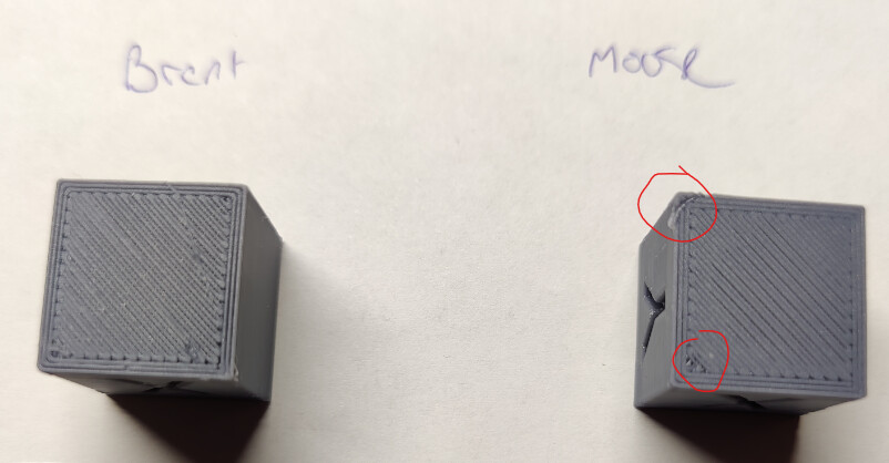

All right, more documentation of events
So, i took your cube as printed and adjusted my cube to the settings i usually like to use plus the fewer perimeters
They both seem pretty nice, but its interesting that some defects in one are not present in the other
I am very excited to dig deep into the gcode you provided to try to see where i differ and try to make some adjustments
so for example on Z, i still have a littttle bit of a gap (in yet another location even), but its waay better. also have a bit of surface problems, not sure if its more of an overlap or an extrusion issue, but im going to find out tomorrow for sure:
next we have X which is quite fascinating to me
here we have circled on the brent cube in the top right corner a tiny bit of jaggedness, i circled that to compare it to mine which has several extra jagged edges and also duplicate on the bottom edge, which def seems like the backlash comp is helping with
i also have some ringing on the left of my cube, however the brent cube has some hair that is not present on the moose cube on the upper right X. ignore the bottom stuff on there thats from the skirt failure
outside of these notes, they are nearly identical, including the hair on X’s lower intersection. really neat stuff
Y is rather unremarkable, the photo doesnt capture well but there is some ringing on both of them. The Y has similar hair to the X. beyond that the same flaws exist in the jaaggedness, with yours being lesser than mine
The bottom side is also close but the brent cube is nicer in terms of overall fill, and mine has a defect from something
i’ll spare the details of the blank sides, suffice it to say, they are not very remarkable outside of ringing.
i guess in reality, at least in terms of my settings, it seems i am nearly at the limit of improvements, at least for a calibration cube. anything else is machine specific such as play in the modules or the bed.
i will do another print after close review of your settings to compare as well
in reality, it should come as no surprise my print is similar to yours… i started with your profile anyhow :joy:
in short, my lessons for the day are - careful with your perimeters and realize the fine details on the gcode preview might leave hints that something may not come out right instead of only showing glaringly obvious things
