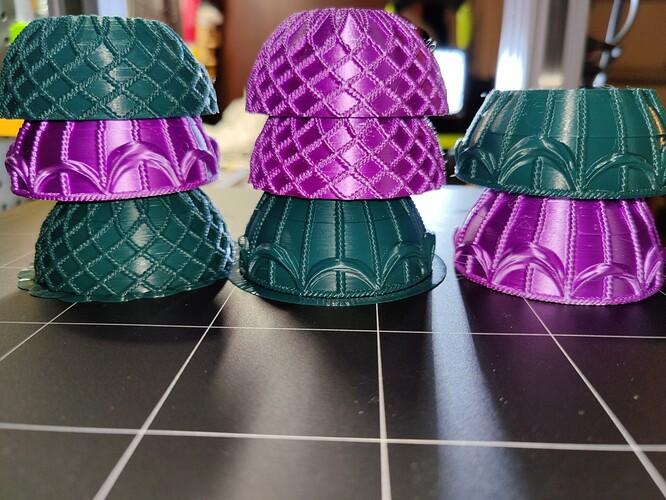

been printing for 2 or 3 days now with no issues, and bam - it happens again last night. layer shift over maybe .5 mm, about an inch or so up the print, on the same freakin balloon i was printing before (which by the way I have several copies of that came out just fine).
so I am thinking that maybe the calibration cube does not have as many ultrafine details as the balloon does which is causing these minor skips in the axis. theres some really good detail going up the entire print with some ropes etc.

gotcha, nope - nice and flat! i have a picture of one of the purple silk pla ones floating around, which were a coming out pretty decent, but this regular green pla is printing realllly nice.
i feel like the detailed braids in the rope continually is causing some hiccups in the stepper, but its hard to prove when their test is to print a 50mm cube that comes out fine. 50 sounds kinda small i think it was more like 60 or 70 actually, i have to go check it.

i think that this is the apex of when the change occured, there are several videos around here and they all seem pretty similar, but i hear some kinda grind sound in this one
the thing is, I marked the print sheet and heated bed with a silver graphite mark in several places, and it doesnt look like the the plate shifted at all.
I am speculating that this noise is occuring inside of the linear module. its at around the 35 second mark, after which alot of the random noise kind of ceases.
I will say, that this time the shift was in a different direction that before, it previously was left to right but this one is now front to back.
If you dont think you see anything in here it may be in a previous or later video, but they all look the freakin same to me. this one had the noise.
its hard to tell, but i have marks around the plate in many places
i circled a couple here.
If the nozzle crashed into the part and caused the plate to shift, those marks should not be lined up anymore, but all of them still are. every single mark lines up with the mating part…
furthermore, this part is firmly cemented to the plate, its not loose and didnt shove over or anything like that. this is a solid piece!

I have temporarily paused the print to take some photos of various examples:
at this point i am just going to go ahead and resume the print and let it complete… not a very impressive present for my dad but apparently the best im going to be able to do.
I have tried this in high quality, medium and fast. the current green example is fast. fast is a 6 and a half hour print, to give you an idea of how hard i tried to make this work…
I have successfully printed this model in the past, however as i used the silk pla the dimensional accuracy was so bad that i was unable to assemble the model, the pegs and basket did not fit. i do not have the model anymore unfortunately.
