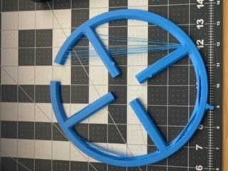

I don’t know if anyone else had this. STL models that printed in Windows Luban 4.2.2 now come up as having Errors in the model. Attempting to repair yields a print that seem to have peeled the “skin” back on the objects and where once an outer shell covered a toroid shape, has multiple arcs that have been directly connected with a piece of filament to one end of the arc. It looks like a badly made “Dream Catcher”
The same model opens up in Cura without errors.+
drip_ring_01
I was able to upgrade to 4.5.1 from INSIDE 4.2.2 - but the installation clobbered all of my previous settings. Then it didn’t want to slice properly, then the printer had difficulties with bed adhesion all of sudden and wouldn’t keep the bed-leveling settings. Tried downgrading to 4.2.2 but the slicing gets stuck at 13.8% each and every single time and couldn’t go forward.
After many attempts to install 4.5.1, I finally deleted the “snapmaker-luban” folder from the %APPDATA% folder (C:\Users\AppData\Roaming\snapmaker-luban). Only then did 4.5.1 started working, and the craziness with my printer stopped as well
