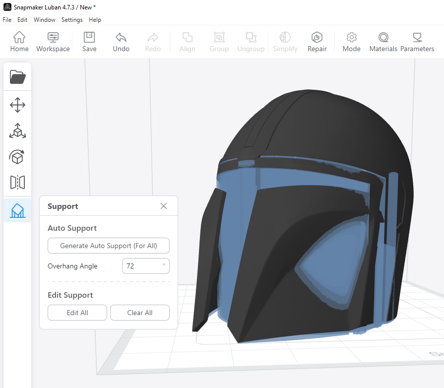

It seems that this feature is incorporated (see the next picture)
In the picture you can see the feature called “Support” where you can edit it… see the next 2 pictures
You have the option to EDIT ALL, then you can +Add or - Delete support
Here is the results after I deleted the support in the middle. The same as Cura.

I had the same problem. For me, the solution was to make sure the Support slider was set to None, otherwise it automatically did full supports and ignored any manual support edits.

This is how I do it:
  • Set Support to NONE
  • Make sure all objects are unselected (or all objects are selected)
  • Open the support dialog and click on ‘Generate Auto Support (For All)’ (this seems to generate the same supports as having Support set to Normal)
  • Then Click on ‘Edit All’ and add and delete supports as wanted
The crucial step is in bold.
