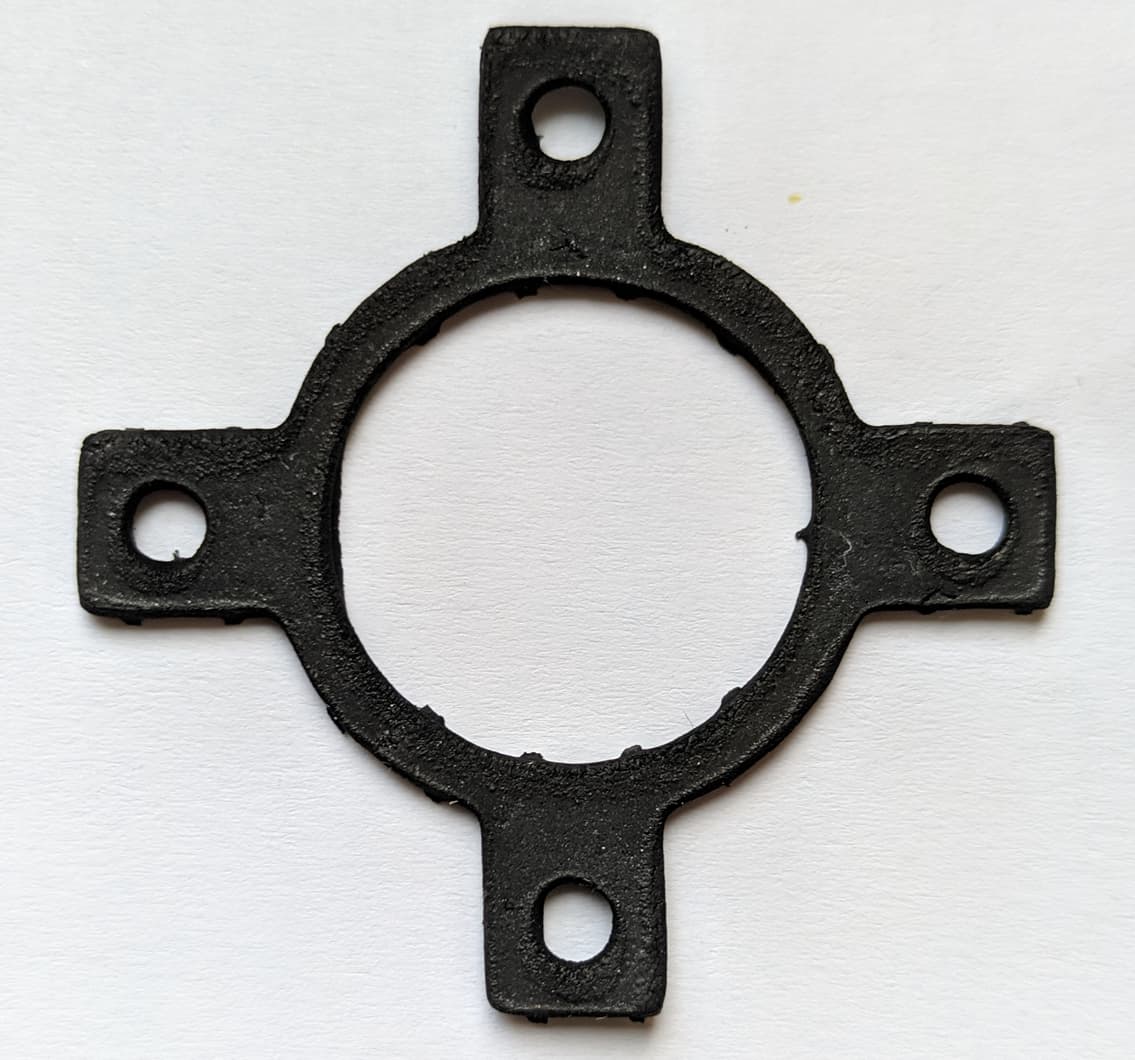

The cut is clean, except for where it directly had contact to the laser platform grid. Perhaps another pass would have burnt away that also. The cut is relatively broad, a lot of material gets burned away, so if you need real precision, add a few fractions of a mm to your shape.
Next time I need something from EPDM, I will consider using classical scissors - it’s a messy thing to laser that stuff :slight_smile:
Here’s a photo (the thing is 5 cm left to right), where you can see the effect of the grid platform:
