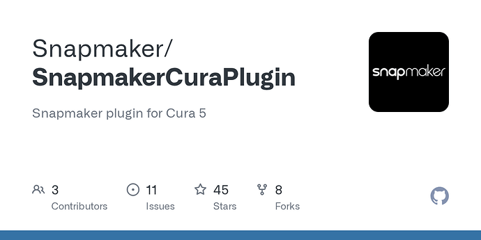

Cura Plugin Updates: V0.9.0
It’s recommended to use the latest Luban or Snapmaker Cura Plugin. We have updated the retraction settings since Luban V4.7.3 and Snapmaker Cura Plugin V0.9.0, which helped to avoid some clogging issues caused by inappropriate retraction settings. If you are using other slicers, here are the recommended retraction settings:
