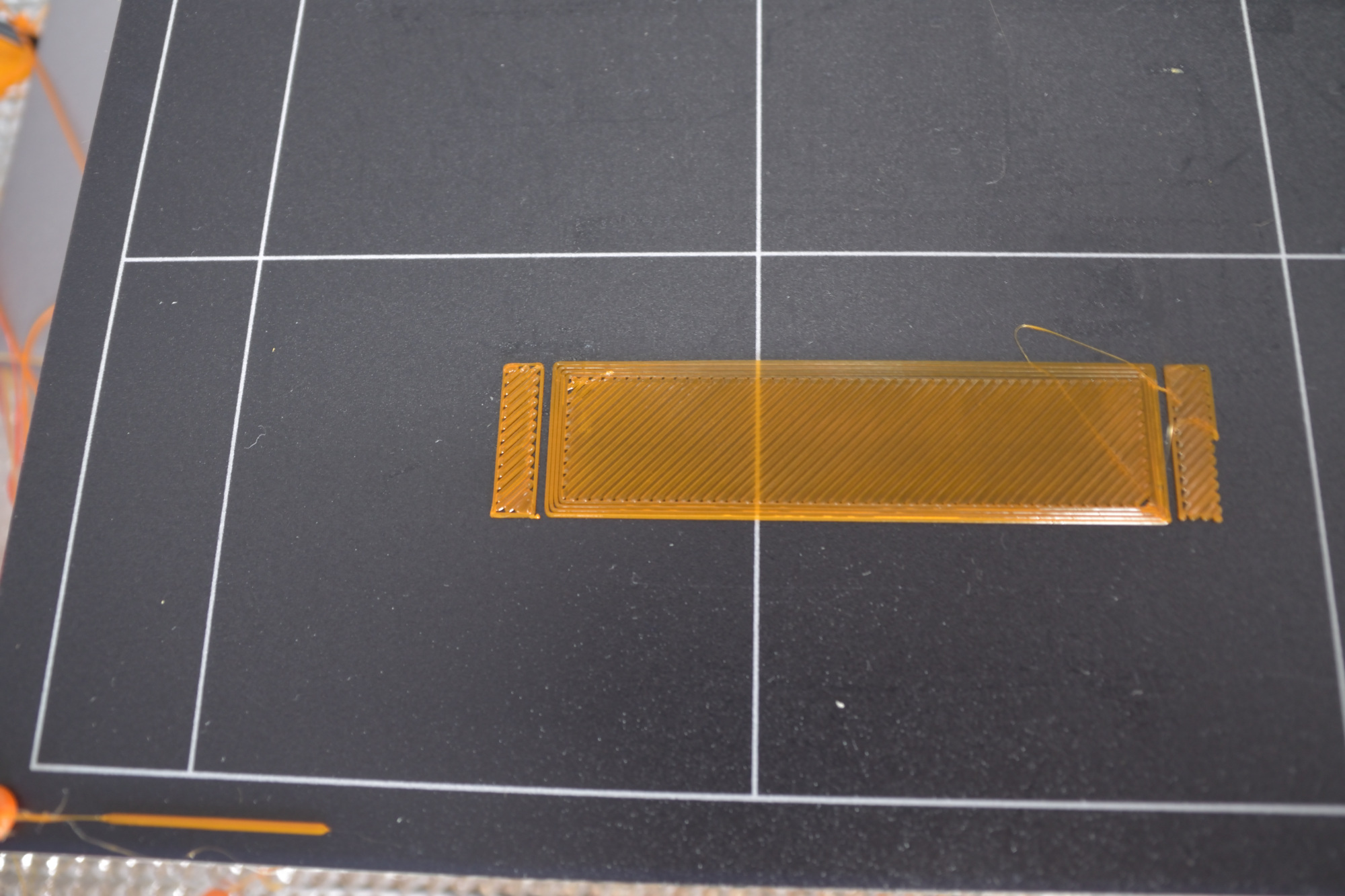

I tried to adjust it.
When issuing commands via Wifi and trying to adjust the Z-axis on the touchscreen, I had to disconnect on the touchscreen screen.
I don’t know if this had an adverse effect, but the first adjustment did not improve the print result.
The part where the filament is peeling is the point where the sensor is detecting.
I thought it was strange, so the second time I did everything from Luban via WIFI.
As a result, the printing results are very good.
We could see variations in thickness, but peeling it off with a scraper revealed that it was firmly fixed to the bed.
Then I rotated the printing sheet 180 degrees to print.
In the second photo, the thickness is close to constant and ideal.
The printing sheet itself also seems to vary in thickness.
It may be that the printting sheet is deformed when it is bent by hand to remove the print.
The 11x11 adjustment is a very pleasing result for me.
Again, thank you, brent113.
Are you always printing in the corner or is this just for testing?
You’ll always have better results in the center. Besides bed level the bed is more evenly heated in the center.
For ABS, use the center of the sheet.
For PLA, use the side of the sheet.
Extend the life of the sheet by changing the printed area.
The sheet will vary in flatness throughout, and changes when hot -

The physical height between the nozzle and the print bed will change based on the warpage of the sheet (from heat).
Yes, adhesion is a factor, but if a sheet warps up higher youll get what you are seeing on yours, the nozzle is too close to properly extrude in that spot, and in others it may be too far away.
I mean you can feel free to just do what you will, im just trying to make a suggestion based on my experience and the information available on the forum.
No. The point is for any warping/expanding/twisting that happens when the bed is at printing temperature to be accounted for when doing the calibration. It’s so that the bed is measured in the same conditions as it will be in when printing.
Calibration is adjusting the z-height across all parts of the bed to compensate for any unevenness int the bed so that the head is at an equal distance as it lays down filament.
The end result of this is that the first layers are at the proper height and that in turn gives proper adhesion.
