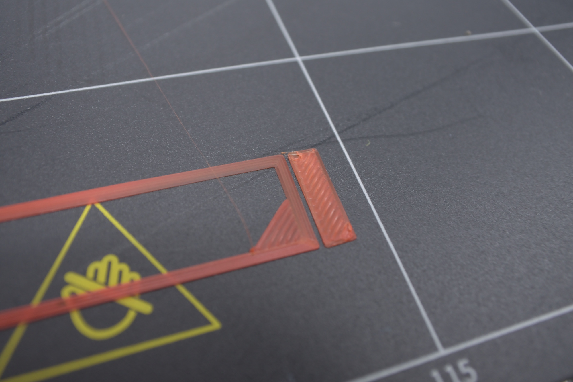

Is automatic level compensation working properly?
I printed the print after performing the automatic leveling.
The right side of the print is well adhered to, but the left side is just barely adhered to.
Sometimes the print fails due to failure to adhere.
From this situation, I can’t say that the automatic level compensation is working well.
Is there a bug in the compensation function?
If there are no bugs, I would like to see more detection points and other measures taken.

A straight-edge ruler revealed the light on the other side.
You can see that the bed is curved.
It coincides with the weak adherence of the filament.
I think the auto-level adjustment is not working properly.

This isn’t an auto-level problem; it’s a problem with the underlying accuracy of the machine.
The result of the auto-leveling measurement is a bilinear function in X and Y. This class of shapes are hyperboloid. They are capable of compensating for only two deviations from ideal:
  • Tilt in the bed. This is when the average surface normal isn’t quite vertical.
  • Twist in the bed. This is when the edges of the bed are not quite parallel, that is, they don’t lie in the same plane.
Smaller deviations, such as the one you illustrate with your picture of a straightedge, cannot be corrected with the current software. At the very minimum, you’d need far more sampling points. Your photo shows deviations from straight with noise features around 10 mm in size. You’d need sampling, at minimum, at half that size to be able to have any hope of correcting it. As an estimate, that’s (330/5)^2 sampling points, or something over 4000 points. If you assume it takes 1 s to sample each point, sampling for calibration would take 2.9 hours. To make matters worse, because the way that the bed is mounted, it’s going to move each time you take it off and remount it. To get anything like 1 s sampling, it means you need an automatic digital measurement system, which could be implemented as a separate work head in an ideal world. The cost of this head would be some small number of hundreds of dollars.
The easiest way to mitigate this is find the flattest part of the bed and print there. Related to this is print in the center of the bed, because it’s more mechanically stable there (less rotation around the axis formed by mounting to the Y-axis linear modules).
Secondarily, planning on printing on rafts, which have the benefit of using plastic fill to provide a level printing surface.
