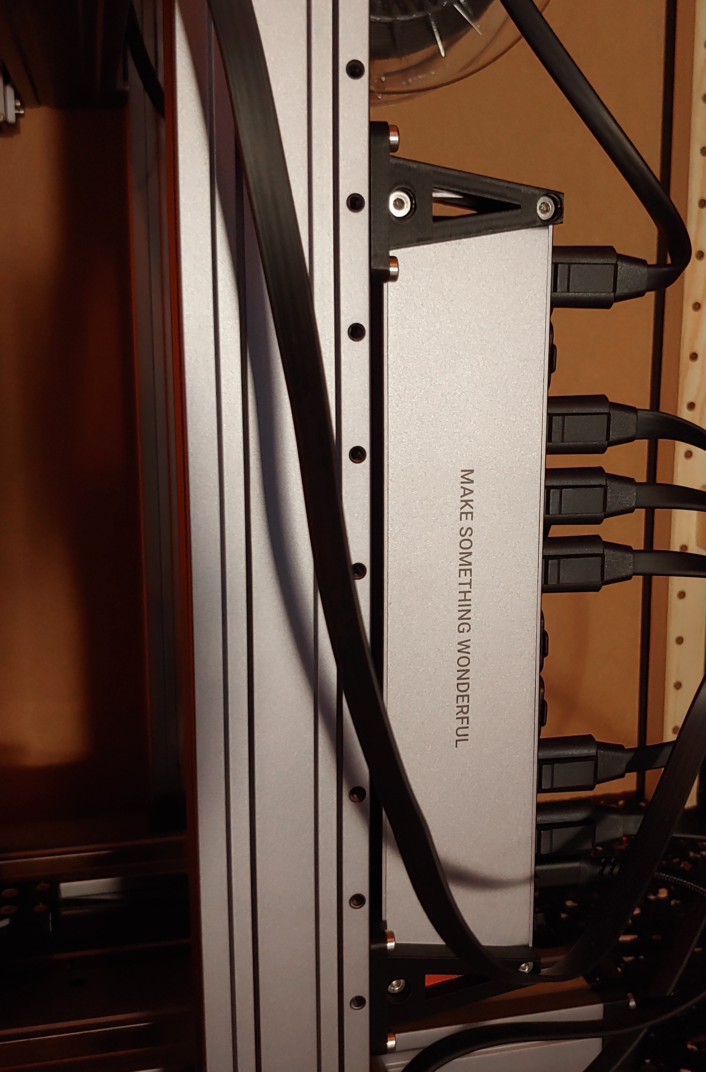

You put quite some effort into this problem. I observed the same situation with my self made enclosure but ended up printing a mounting bracket for the controller so that the terminals face backwards:
For the linear modules the cable lengths are fine so this doesn’t impact the axis movements. Still went for extension cables for the USB-terminals so accessing those is easier and to reduce the strain on the Touchscreen cable.
Can I get a copy of the STL files for those brackets because I would love to use them for my 2 SnapMakers because I am running into the same issue with the enclosure doors?
Is there a link to the stl file for this bracket?
Sorry for not answering earlier! I will try to upload the files today.
Here you go:
Controller.stl (320.2 KB)
Thank you! I appreciate what you created.
