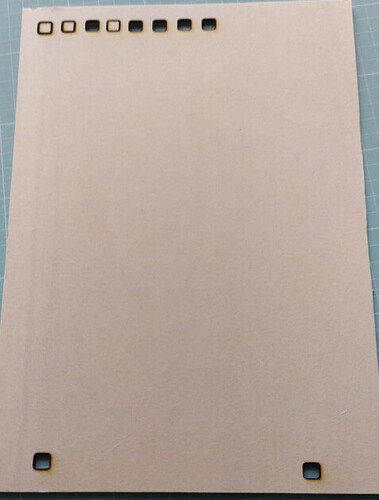

So I did a lot of research and tests and want to share it with other who have similiar problems.
I did not found yet the optimal solution but a way to at least archive what I wanted.
First of all, it all goes and falls with the material as brent mentioned first here. I tried plywood from local stores and a lot more from the internet.
Basswood and pine works the best right now. but it hardly depends on each (!) sheet. Some sheets from the same package have another result with the same properties as the next one. I am not sure if this is because the glue is different or whatever.
This is what I have done before testing:
  • Firmware update
  • Calibrating the Laser as Brent suggested
    (@brent113 the Calibration is fine and works good now, it was somehow the wood who did this…)
Then I created a Testproject within Luban where I cutted 10 different squares out of my material on different sheets.
I am sure some of you get headache with some of this properties, but since I got no experience, I just tried a few things.
Result:
Some of worked on every plate others not. The 10 is the best choice for me and this material at the moment. On another sheet of wood from another supplier the 5 works very well too!
may this helps someone who struggle the same way as me.
If I find the perfect match i’ll update this.
thanks a lot brent for helping me out!
