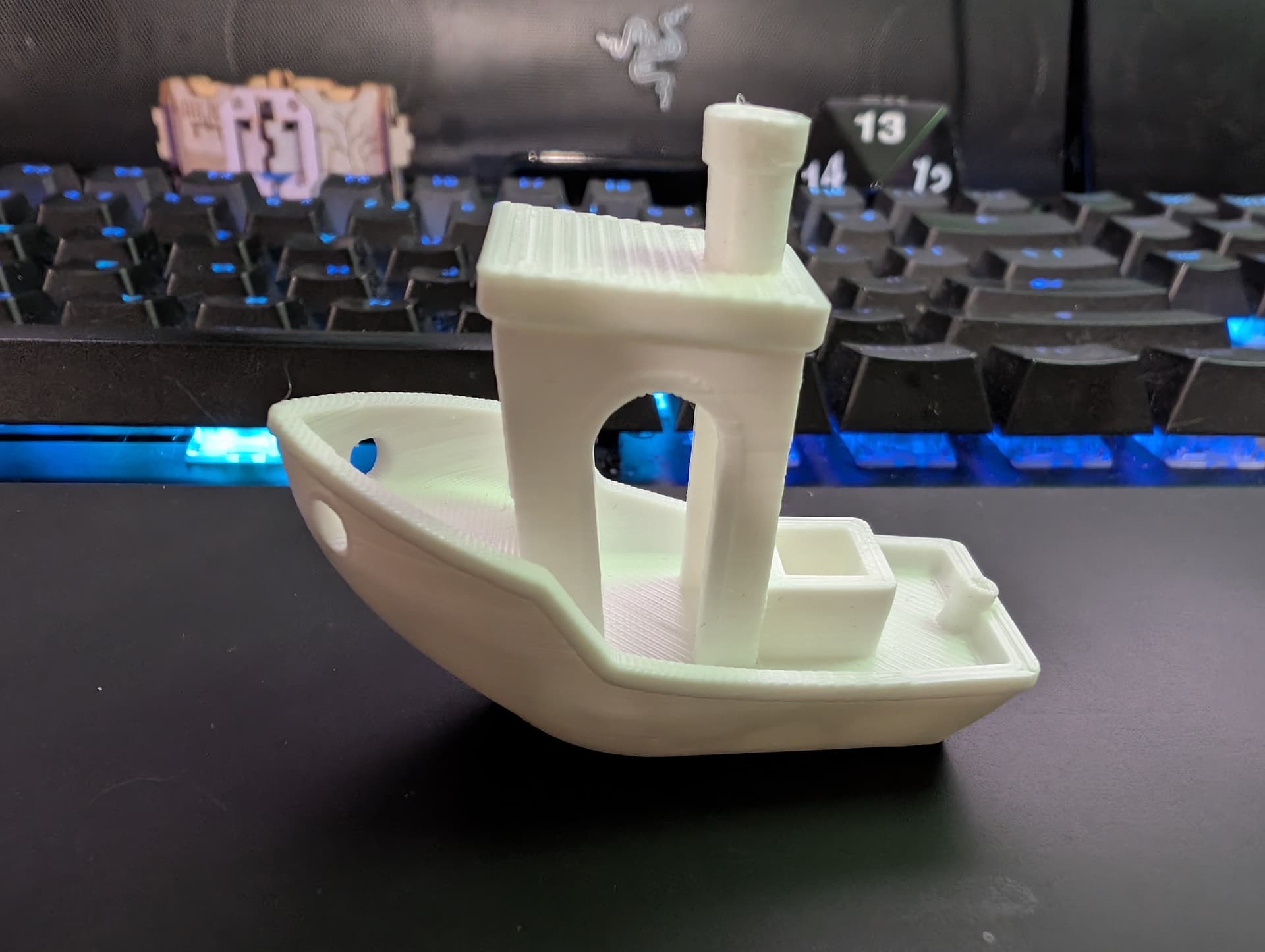

I’ve gone through calibration of both nozzles, and individually, they both print fine. Benchy comes out fine when printed from either left or right nozzle.

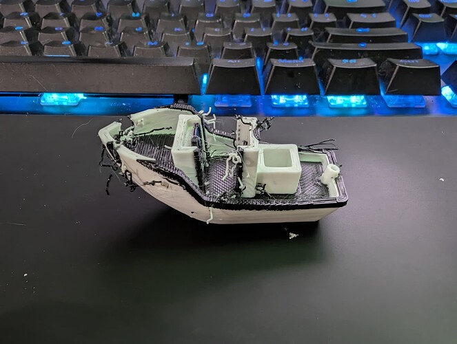

however when trying to print dual version of Benchy, I get the following. First is sliced with Snapmaker Luban, second was with Snapmaker Orca to see if that would make a difference.
I stopped the second as it was obviously not gonna come out right.

Hmmm - difficult to say if you have stringing or oozing. It looks more like oozing, so here’s what to check if I’m right:
  • Do you use a prime tower? If not: Do!

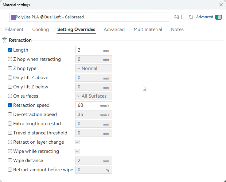

  • What are your retraction settings? Try to increase retraction on nozzle change, unless you already have double-digit values.
  • Lower the standby temperature for the inactive nozzle.
Oozing means that while Nozzle A is printing, a bit of material creeps out of the inactive nozzle B, which then is deposited on the print at the next color change position. When you observe the print process, you should see that. Retracting more and/or lowering standby temperature can reduce or eliminate this oozing. The prime tower will also help, as it is the position for the color change, so the oozed material will be deposited there. Also, the prime tower ensures that the nozzle pressure is good, avoiding underextrusion due to the lost material.

  • Retraction settings below (both Luban & Orca)

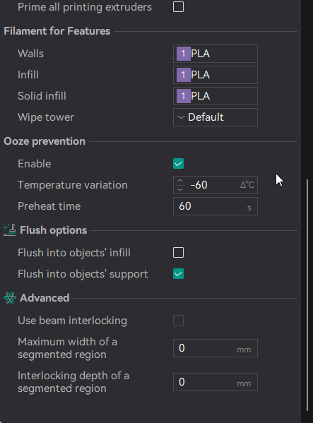

  • screenshot added of Multimaterial Ooze prevention in Orca. I think this means that the other nozzle will be 60 degrees lower than active nozzle? in which case, I would think that’s okay to prevent oozing? but by all means tell me if I’m wrong.

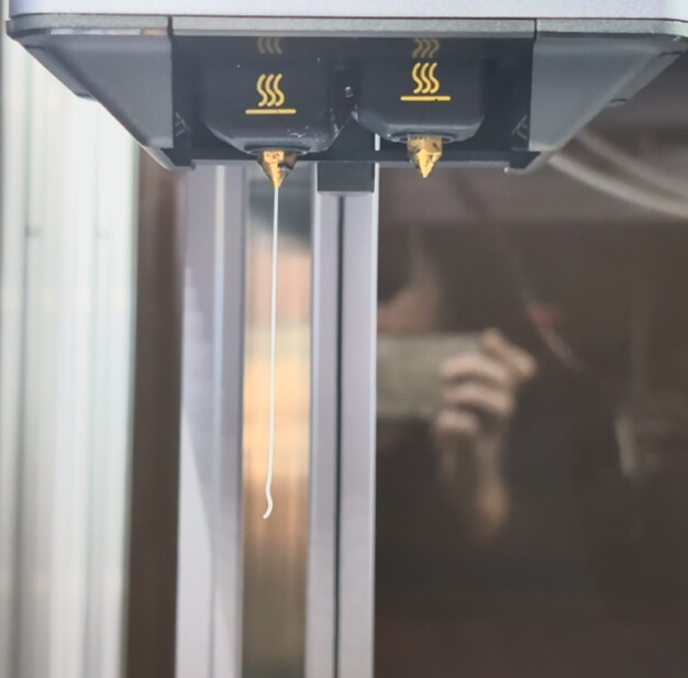

another thing I’ve noticed which may be related is that the left nozzle when heating oozes quite a lot when it’s not doing anything, even when doing a print that only uses left nozzle, as in a full 8-10” of material just dangling. I noticed that the extruder does do an “initiall pass” on the front of the bed to seemingly account for this, but the previous single extruder didn’t have any type of oozing issues. Could this be a contributing factor?

so I just tried heating up the left nozzle up to 190, and within a few seconds, it started oozing out. See pic after about a minute. I just googled Ooze Shield, is this a feature of a particular slicer that can add it to a print? I will test the different toolchange-retraction-speeds tomorrow.

The oozing out after one minute does not look unusual to me with 190°C temperature.
2 mm retraction length is not much, as others said: Increase, up to a max of ~15 mm - beyond that you risk clogs due to molten filament getting back into the cold zone. Perhaps start with 6-8 mm or so. The Luban setting is already 16mm, which is a lot. You had the oozing with this setting also?
Standby-Temp: I only see the Luban setting with 150°C - perhaps go for 130°C or so.

default retraction on orca was only 0.5mm. I changed it to 3 and am starting another dual benchy, we’ll see what happens.
setting retraction within Orca to 3mm did make a difference. Not as clean as I’d like, but definitely better. I will try with a higher retraction settings after this weekend.
