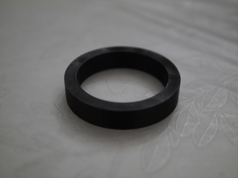

I have done what I could think of, but I fail to find the reason behind this repeating helix pattern on the outside and inside wall surface:
The error measures around 0.15mm. The actual object is this (in this print orientation sliced with Cura):
ring.stl (113.0 KB)

I had a more complex variant of the ring above first:
The issue showed up exactly in the same way at the same places (top left outside and bottom right inside).
Any idea what I can try or what I am facing here? The pattern is always the same…

Maybe I missed it, what’s the pitch of that pattern. Does it align to a fraction of the lead screw pitch of 8mm?
I’m assuming it’s not a helix but a repeating pattern of circles vertically at regular intervals? Or does it actually spiral up the side.
It is an actual helix with a pitch of around 1.8mm going up in counter-clockwise direction. The pitch is increasing slightly as it goes up.

In the meanwhile I have printed the ring in the back left corner and back right corner with the same result as before. The helix appears on the left back side of the ring (see red lines below) regardless of the placement on the print bed. With no negative pattern on the other side. Given your theory is right shouldn’t there be a corner with a stronger and one with a weaker effect? Is there a way to fix or compensate the issue you described to see if it gets better?

It would be interesting to hear from others if they have also noticed such an issue. Re-evaluating my old prints I found that this not just happened recently to me.
I did not notice it at first but there is actual a difference in the pitch of the helix depending on the print bed position (the bottom of the part is on the right side). Does that assists your theory @brent113?

I do not think so. I did another print at the right center to make sure. This looks very similar to the back right one. The pitch gets smaller on the left side and wider on the right side. No idea how much the back/front position adds to this though.
