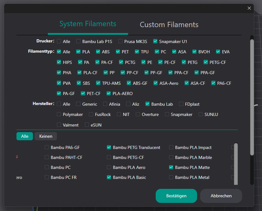

Go to the settings icon for filaments.
Select all filaments you want to transfer.
Click Confirm once.

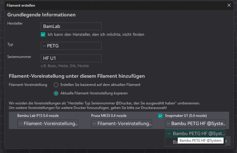

Then go back to the filament settings, then to Custom Filaments and Create New!
Create a new filament profile for the Snapmaker U1 based on the profile you added in the previous step. Bambu is not listed as a manufacturer and cannot be written, so I chose BamLab. The serial number MUST be filled in, otherwise an error message will appear.

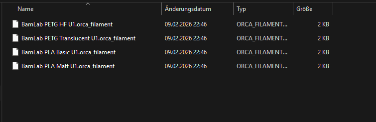

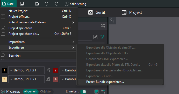

Each filament must be created anew. It’s quick, though. After that, the custom profiles can be exported. The profiles can then be imported into SnOrca.
Here are the following images from SnOrca:

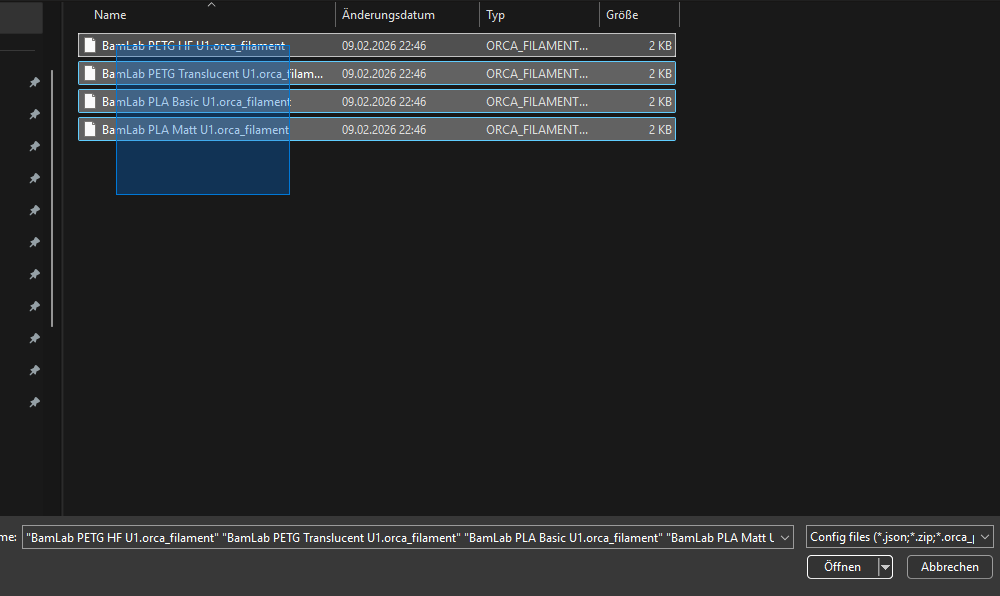

All data can be imported at once.
After that, the user profiles are available in SnOrca.

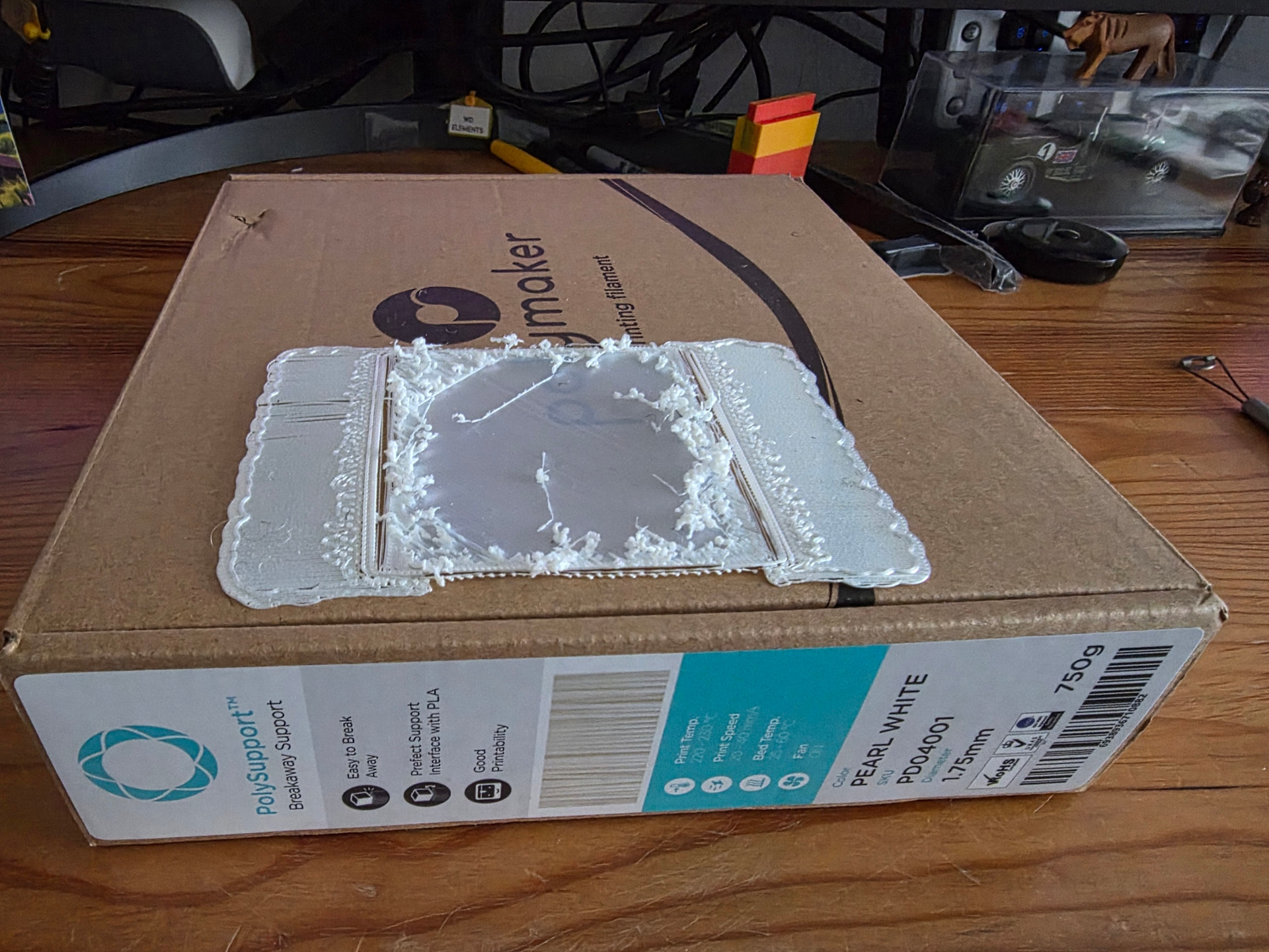

Can anybody help me as I’m trying use Polymaker PolySupport breakaway support for PLA because Snapspeed support filament for PLA is sold out for UK on the Snapmaker Global site having spoken to support.
As you can see in the image the issue comes after the first layer where I think at the nozzle is crushing into print layer because it seems to push it off. I created a custom custom filament Profile using the settings from the Polymaker
website With the aid of Google AI But it would be nice if I could import them directly from Orca Slicer Software But lo and behold there is no Polly maker filaments for PLA in the standard filaments to be able to transfer using your method, do you think you could help me with this issue in the image Or create a custom profile?
