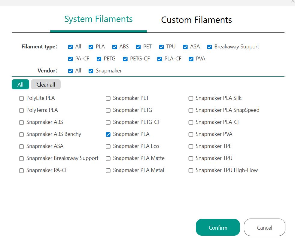

Why do I see in SM Orca Snapmaker filaments only and no other brands as shown in GitHub?Regardless revision.
Why can I not import filament bundles from original Orca Slicer?
Would help to know what version you are using…
@nweolu
Snapmaker Orca 2.1.1
Orca Slicer 2.3.1
I have the exact same problem. I had Snapmaker Orca version 1.2.1 installed, then updated to 2.1.1.
I also have the latest OrcaSlicer version 2.3.1 installed.
I was hoping for ready-made presets for Polymaker filament after the update, but they’re not listed here.
I have the same question and also an issue with importing Filament Profiles.

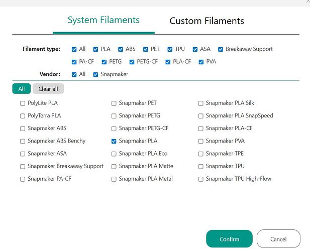

Anyone been able to get past this or is it my install has an issue? Below are screen shots from Snap-Orca and Native Orca.
Native Orca will allow you to assign the filament profile to all of my installed printers but Snapmaker Orca only allows this on the U1.
