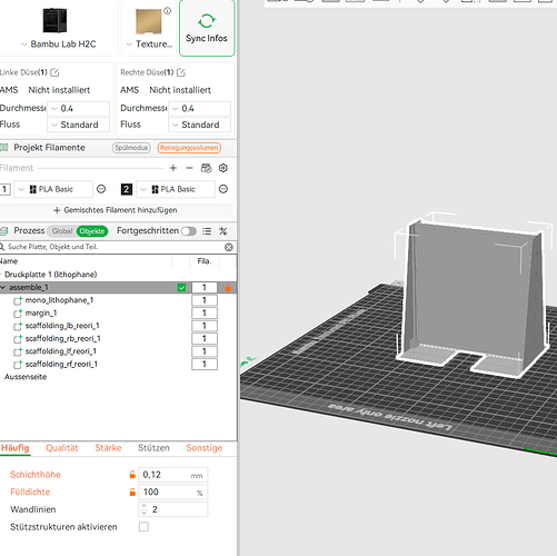

Wouldn’t it also be possible to convert the other settings? For example, layer height - fill density, etc.
This makes a lot of sense for lithophane prints, for instance. You wouldn’t need to load the *.3mf file in Bambu Studio first just to transfer the settings to the U1.
