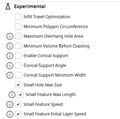

I then found a experimental settings (Cura 5.9) for “Small Features.” The purpose of this is to detect small extrusions of a given length, then reduce the print speed just for those features:
(You likely need to enable these setting’s visibility:)
By telling it to slow wayyyy down for these extrusions, but otherwise print normally with still a snappy travel speed and acceleration, the stringing went away.
Hindsight theory being that for very small extrusions (I later set it to a Max Feature Length of about 10 mm, or half this), it doesn’t have enough time to extrude, stick, and cool. This results in horrible stringing in a variety of prints where there’s small extrusions.
By enabling this feature in Cura and setting it to slow way down only for them, the rest of the print can proceed quickly but the stringing is significantly reduced on these small features. This is the improvement in the spires straight off the print bed:
