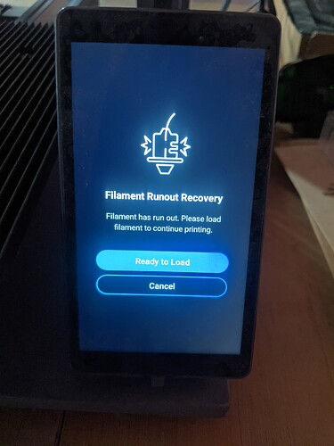

Hello,
Recently, The Snapmaker 2.0 has been bringing an error "filament Recovery error " while Laser Engraving. Which is very odd to being with.
I am on Firmware Version 1.81

No, the screen when it’s ready to be used after starting up.
This One?
Odd.
Check your cable connections.
For the update, try it with a different head connected, no need to to mount it.

Cause it just shift from Laser Engraving to Bringing Up an error that filament is out while Engraving.
Try a different usb thumb drive and wait for at least 30mins. Sometimes the update needs that long (mostly if there where touchscreen changes, I guess).
