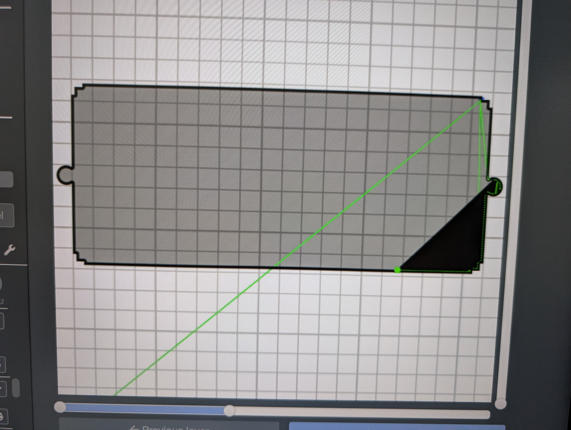

Can anyone take a look at these images and give me an idea of the cause? Original A350; eSun eSilk PLA and with the same maker’s PLA. Initial printing temperature is 200˚C. Model sliced with Cura and printing with octopi.
I was printing multiple copies of the same model, when out of the blue, I can’t lay down the base layer. Adhesion is poor and extrusion seems inconsistent. Like in total, the correct amount of filament is extruded, but with periodic under- and over-extrusion.
Edit: Also something I’ve never seen before. After cancelling, the print head leaves a vertical filament stringer, which is visible in the front right of the print. It seems that extrusion has suddenly gone wonky.

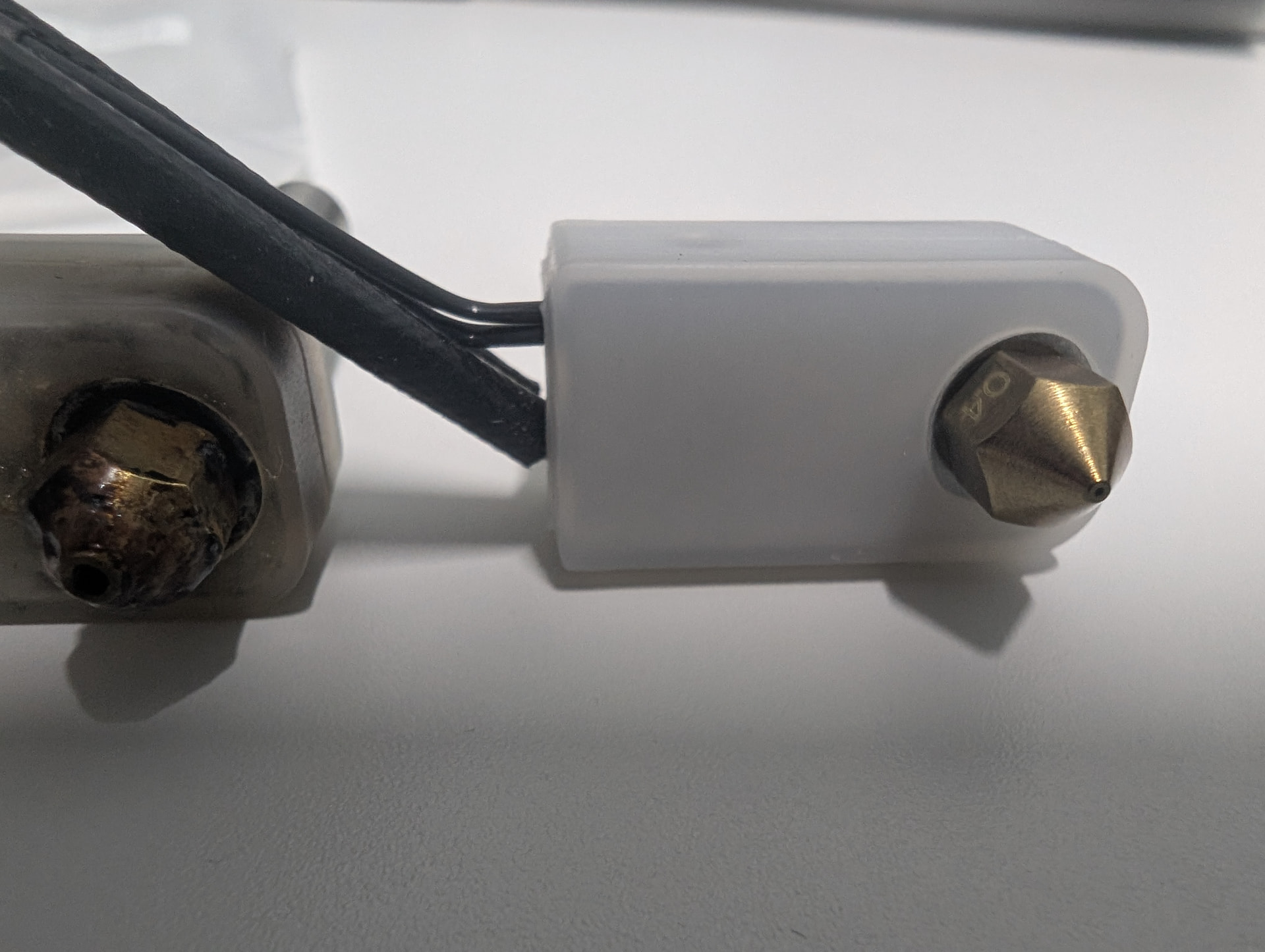

When did you replaced the nozzle last time? Brass nozzles are consumables and have to be replaced from time to time. Especially when using silk, glow in the dark, or other abrasive filaments.

I have never changed the nozzle and I do indeed print a lot with the eSilk filament. I have never worked on a print head. I see that this came with a “hot end kit”. Is it possible to only change the nozzle, or would I need to replace the entire hot end?

Well, the nozzle definitely needs to be replaced. Is it better to replace the entire hotend? or just the nozzle? The opening is more than 1 mm. I can push the end of a 1 mm diameter paper clip through the opening.
Snapmaker is just selling the whole hotends. But mk8 nozzles are compatible, so you can just change that. But take care, that the proximity sensor is correct adjusted when the new nozzles are “to long". It is also possible that the width of other mk8 nozzles do not fit into the hot end socks, then you have to cut them wider. Both is possible without any problem.
What a difference a nozzle makes.
glad to read that. :+1:
Wow, I didn’t realize how abrasive the glow in the dark PLA is. I’ve been using the same nozzle for years with eSilk and no issues. I received a free glow in the dark spool from the vendor that previously distributed snapmaker in my country, and just started using it. I’ve perhaps used 500 g in total.
The nozzle on the hotend I just swapped is already toast. It seems that one brass nozzle can print about 250 g of the eSun glow in the dark PLA. The opening is already >1 mm.
