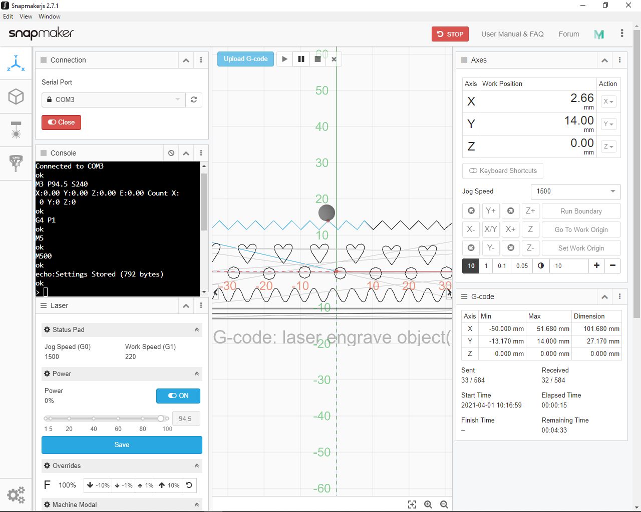

Step 4: Prepare an image you like, e.g. in Inkscape. The image size is 100 x about 35 mm (one revolution = 100 mm). Now the X-axis is the horizontal axis, the ‘equator’ of the egg and the Y-axis is vertical.
Step 5: Place the egg (Use boiled white eggs.), position and focus the laser in the middle of the egg and the middle of the rack as origin.
Step 6: Print the egg! (at ~100% laser power)
(I used SnapmakerJS to operate Snapmaker because Luban 3.14 is not working any more:)
