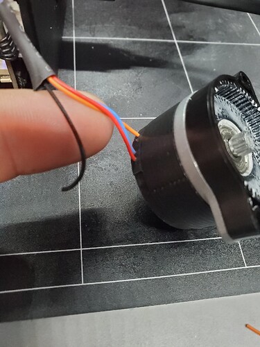

Same issue just occurred for me today.
R extruder drive will not rotate as commanded but will rotated if pushed.
Also creates a buzzing sound.
Will let everyone know what support says

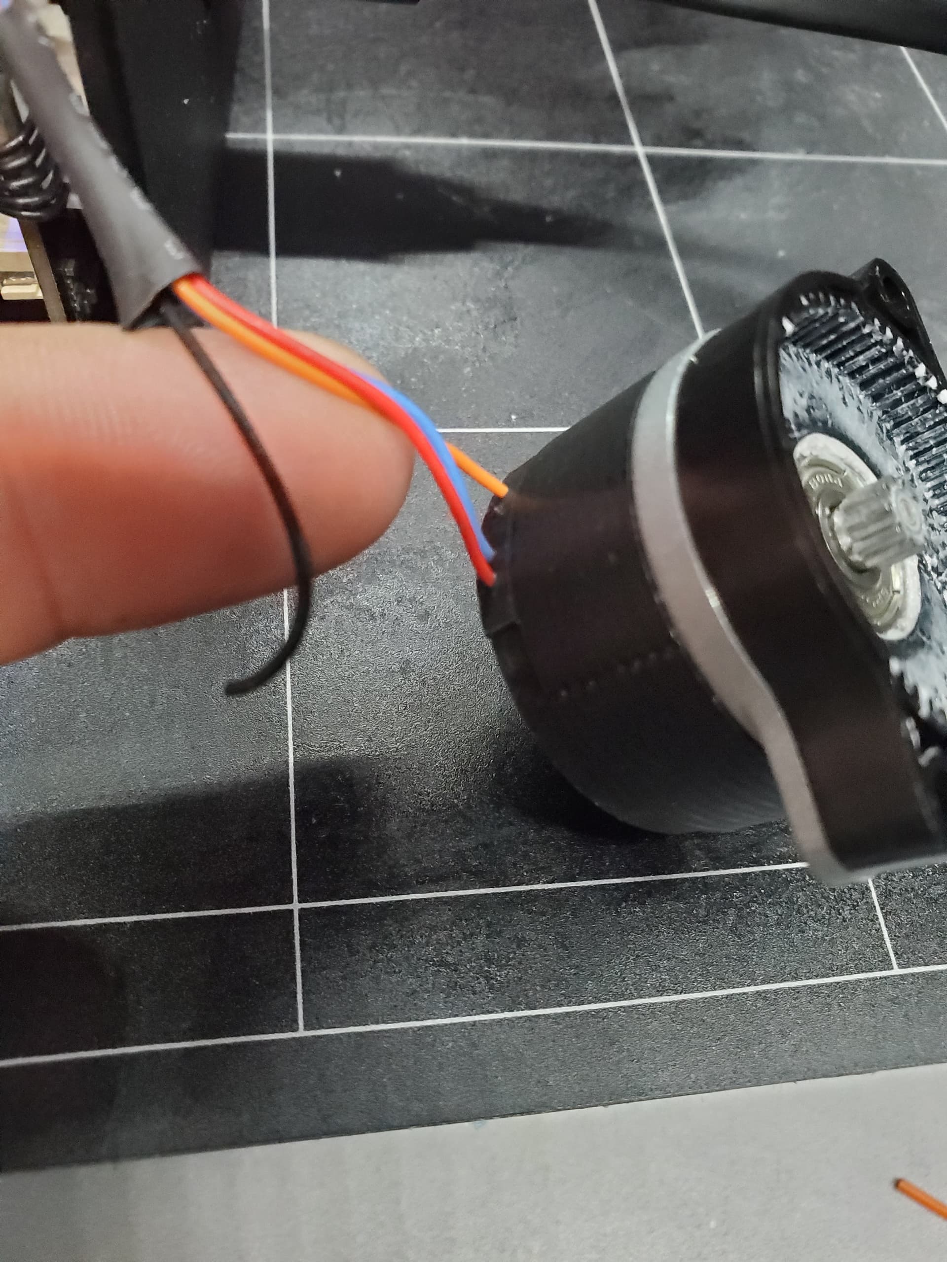

missed the other end of the wire!!! For me it wasnt the white connector it was where the wire attaches to the motor.
Must of gotten pinched when i took it apart with the new door and filament breakage sensor upgrade.
So check the very tiny wires and the connection to the motor. Remember for me this is the right hand extruder which is the one that moves up and down for the filament change. Might be a bad design for a motor that moves up and down as much as this one does.
