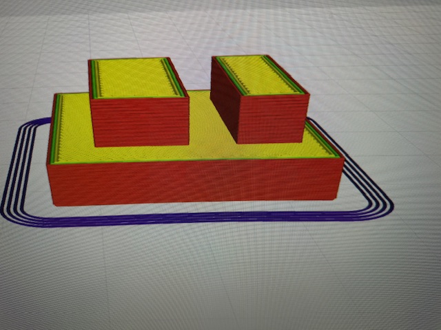

When the Dual Extruder changes the extruder it seems to lose the z-axis position. I Print with the left extruder and all is fine. Print with the right, same thing all is fine. Print first layer of the dual filament design (example 5mm) and print is great. At the next layer with an extruder change, the hot end is now pressing into the surface. I can use the exact same design and swap colors and the same thing happens. See photos. Anyone have any ideas? I’m going to look at the G-Code, but it seems like it’s something with the machine versus the G-code. I spent time watching layers get processed and the problem started just after the first extruder change to the second extruder. The first layer after the change was clearly pressing into the previous layers.

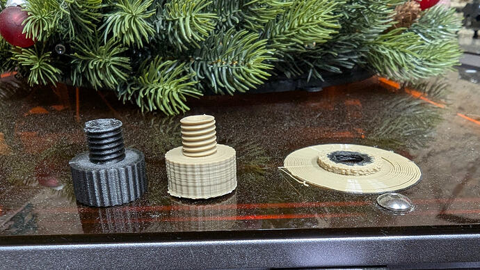

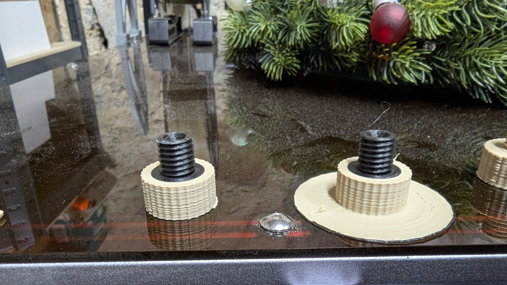

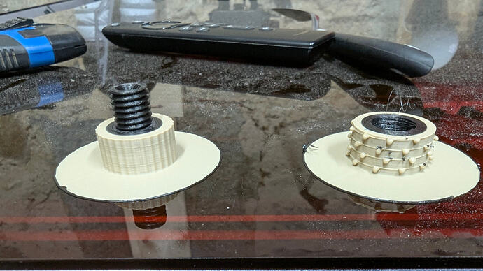

Hello, the issue has been present since today with the calibration model. The Z-height appears as if the extruder is not moving up properly. I am sending images of the calibration model and a print, each from the left/right sides, and then combined.
Best regards,
Alexander
I would start at scratch and reset the machine settings by entering M502 in the terminal and save the default settings by M500. Power cycling is not bad anyway to get sure there is no glitch.
After this you need to do the whole calibration process once more.
Opening a ticket is a good idea either.
I’ll try that tomorrow, thanks.
I have reset the machine and performed all calibrations. Everything is now working as desired. Thank you for your help!
The layers in the light coloured material are not great…
Yes, the printer is in the barn at 8 degrees, and the filament is not dried. I don’t think that will get better for now… I printed with Orca, so I should also reduce the speed significantly to a maximum of 50mm.
much better with dried filament! I think I’ve also found the error causing the height offset. In Luban, you can select different profiles with different layer heights for the left and right extruder—if you’re not careful. If you don’t notice this, the result will be as described in the initial problem. If both are set the same, the result is excellent.
