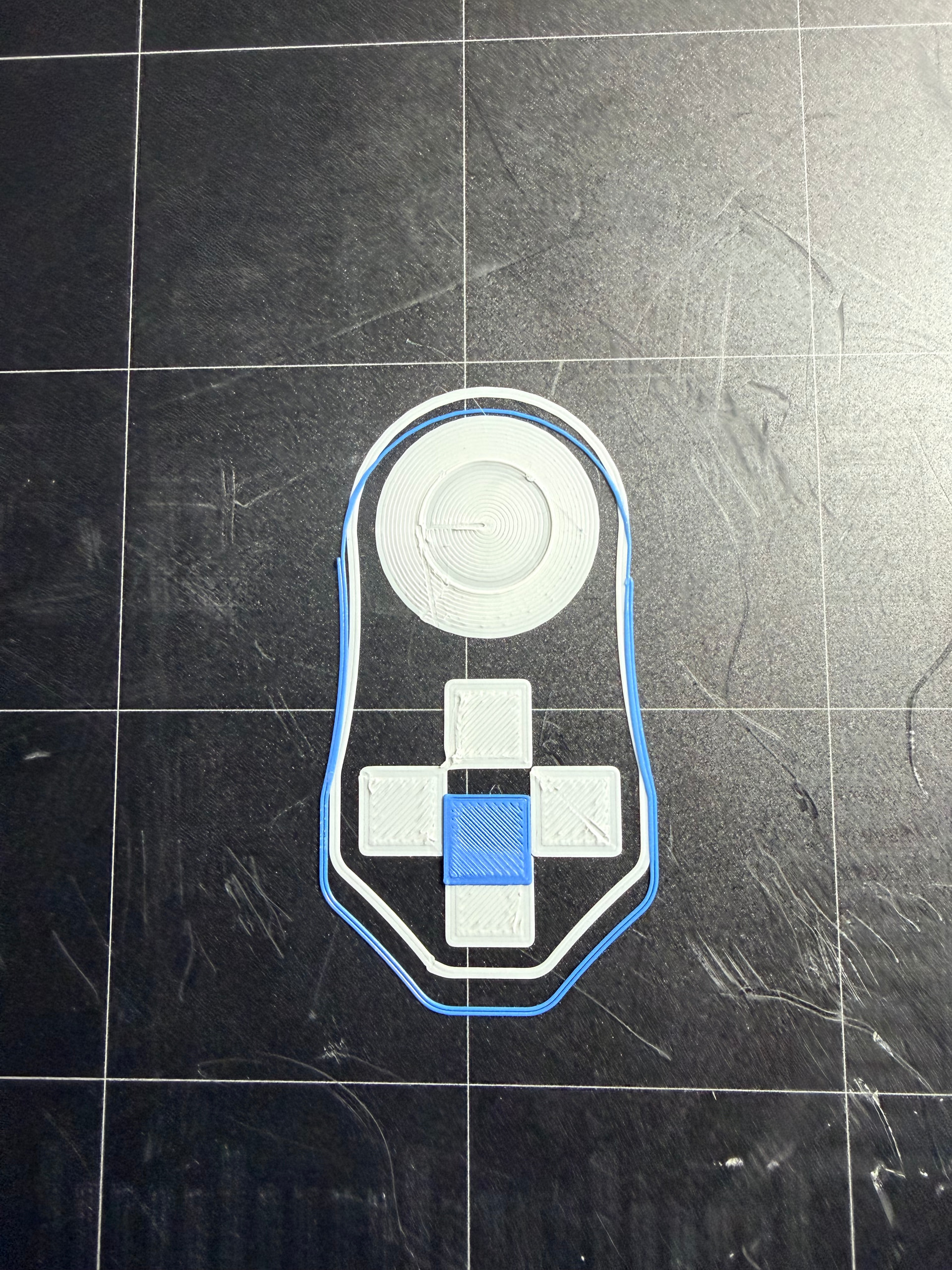

I just received a new dual extruder module and I can’t seem to get the calibration right. The issue seems to be with the XY calibration. The X axis seems fine but the Y axis is just off, as can be seen in the attached picture. Could this be a bad module?
Any suggestions or help would be greatly appreciated.
So much offset cant be a bad head. To much offset for a hardware problem I think. Try to reset your Maschine to factory defaults (Open luban, Switch to workbench, connect to machine and send M502 and M500, restart maschine). And check for newest firmware version and try again.

However, I did try running an XY Calibration and the print doesn’t even work. I attached a picture of the XY Calibration and you can notice that on the Y axis, the blue color didn’t even print on the white at the very top. It’s off by a lot.

Dumb questions. But when you have a look to the hotends, they seem to be parallel to the whole print head?
No, they are not in parallel.
The right head was forward. I opened the door and pushed on it, and it snapped into place.

Now it looks like the right extruder head isn’t moving up and down. I’m going to try taking it apart and see if I can see what’s going on.
