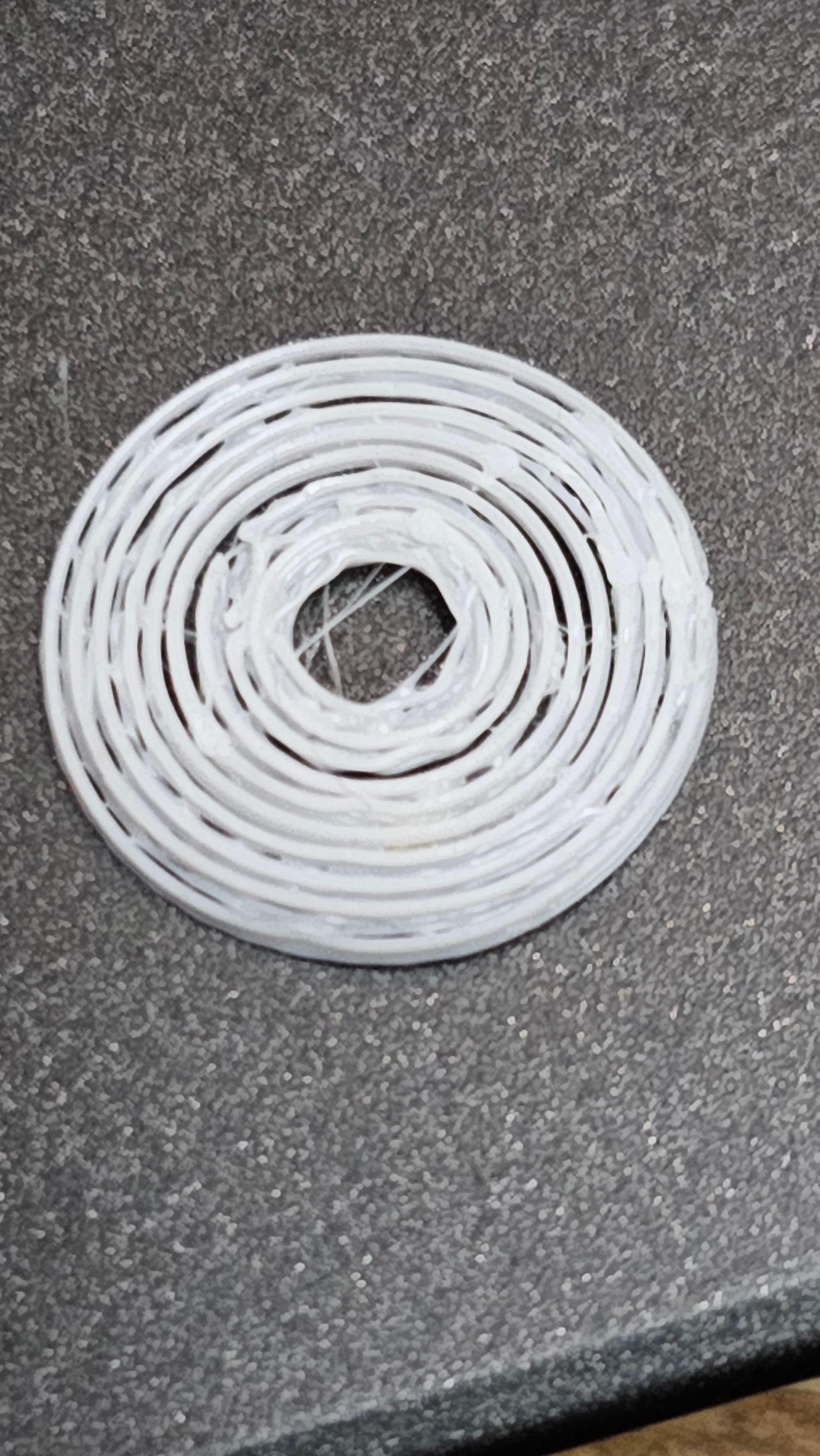

I had to recalibrate again, after I switched the machine off - again it started printing about 3cm over the sheet (printing into air)
Could it be, I used the “wrong” mounting holes???

I mounted the print head the way the manual says - I will see, if the re-calibrating issue will disappear.
Other than that I’m having issues with the print settings… I seem to get no solid object out of the dual extruder and I don’t know if this is a calibration or a settings problem
The model in the pic was meant to be solid (100% infill)
The image looks like you’re printing too high. Perhaps try to use the on-the-fly controls to fine-adjust the Z-offset.
I think you’re right… on the fly seems not to work while the machine is connected via USB - maybe I will try via WiFi and/or calibrating Z manually instead of automatically…
Lots to learn and find out …

Update on my issues:
  • I mounted the print head on the “right” holes - now I don’t need to re-calibrate everytime I switched the machine off and on - it keeps the settings
  • printing with USB-connection still shows “single extruder” connected - but prints in two colors without trouble
  • calibrating Z manually did the job, now I get a proper first layer other than shown on the picture above
