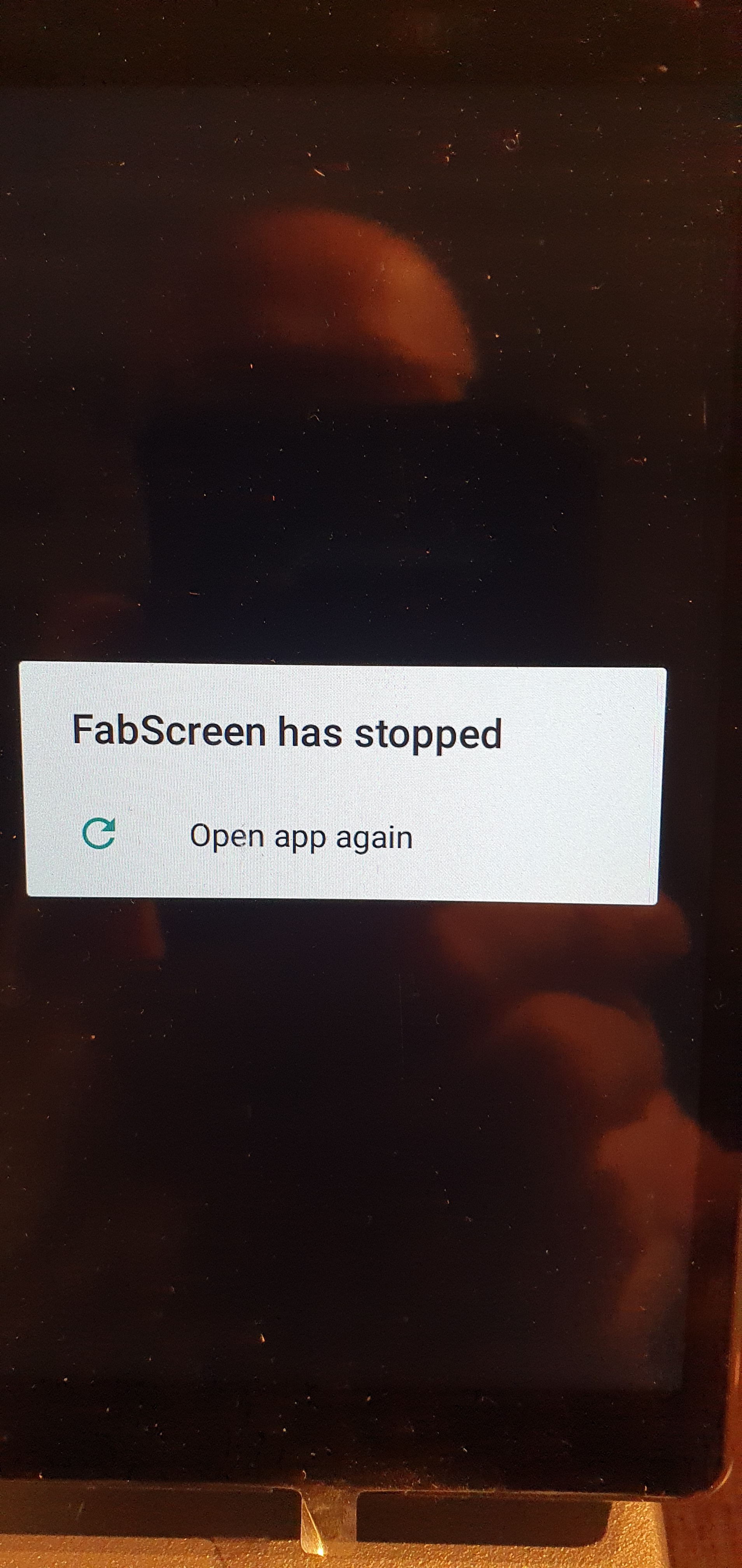

I have tried the settings you recommended and it looks like it works OK if you simply run the file.
But in the first screen on SM2, see the enclosed picture, a huge number can be seen in the place under the file name where the size of the job use to be, and when I run a boundary check it gives me the screen with the “FabScreen has stopped” I enclose the cnc file I ran when this occurred maybe the Forum can see what is wrong in the cnc file.

Well there’s your problem, your toolhead is 35967872420077830000 lightyears to the left.
??? lmao no idea why the touchscreen crashed, the gcode looks fine, except for it’s calling for 24000rpm on the spindle. Try changing the 24000 to 12000

I changed my spindle speed but I still get the “FabScreen has stopped” whatever that means!
I looked in a file of the same object made by LUBAN I can´t se any where a line sending the size of the job
Except if it is hided in the graphic “chitchat” in the beginning of the file.
Has anybody experienced the same as me please let me know how you resolved the problem .
Just for testing purposes you could remove the image and other junk and see if that fixes it.
