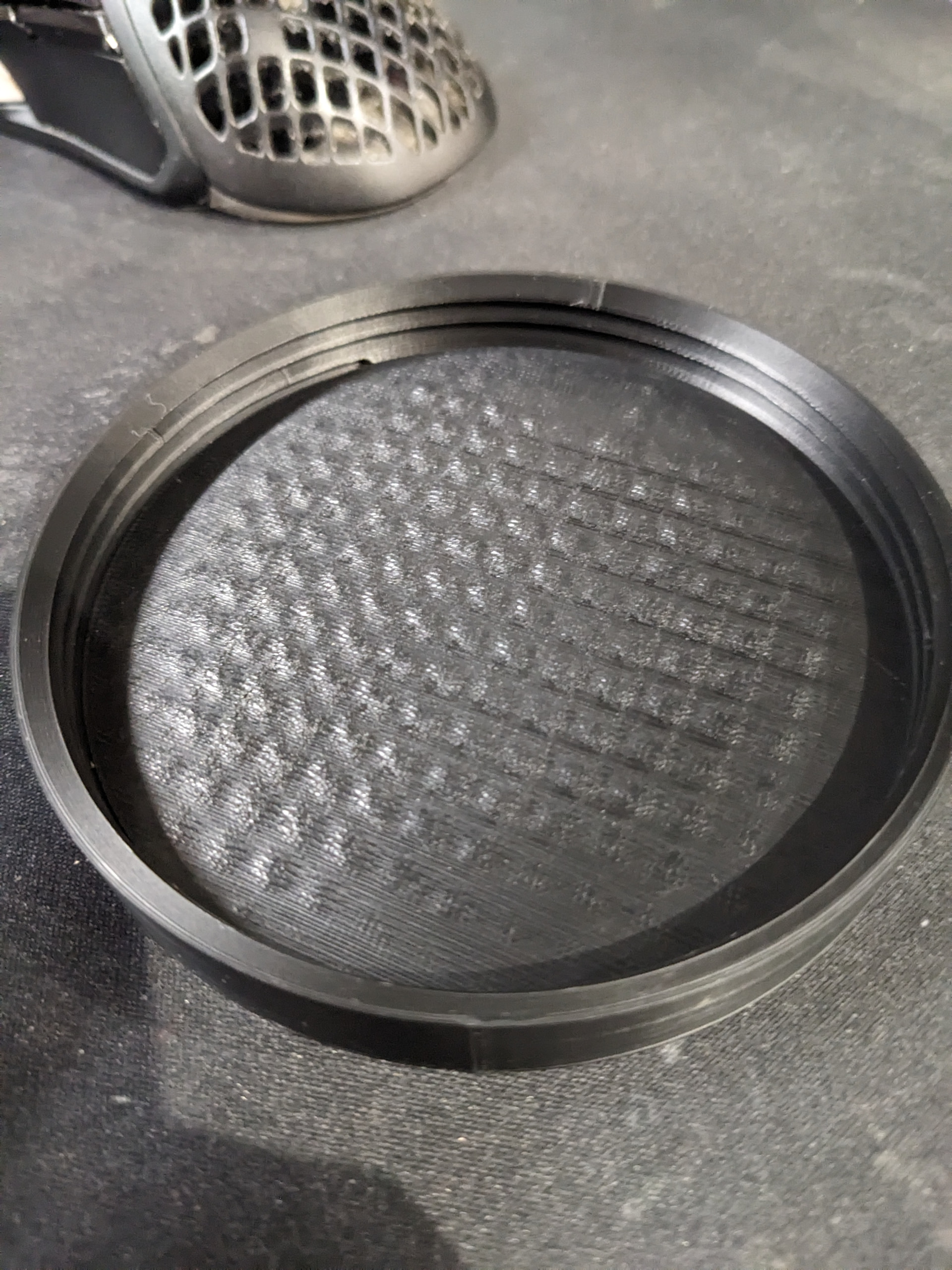

I’m printing using the filament that came with the printer and the default settings in SnapMaker Orca. Print quality is generally very good, but I’ve noticed that when I print relatively thin flat designs (around 5mm thick) the top surface blisters up slightly over the cells of the infill. This is very odd as if anything I would expect the surface to sag into the cells. It looks like the air in the cells is expanding and pushing the top surface up like inflating a balloon. It is quite subtle on the finished print, but observing the printing of the last few layers I can hear and see that the nozzle is scraping on the domed surface of the previous layer which cannot be good. I tried un-checking ‘Only one wall on top surfaces’ but that made it noticeably worse.

Thanks Simon. The defect does look very much like this picture, but a bit less pronounced and more localised. However I’m still using the filament that came with the printer and it has been indoor at constant room temperature and humidity since the pack was unsealed less than a month ago. The bottom of the print (the first layer, touching the heated bed) could not be more perfect! Having come from a Snapmaker 2.0, one thing that seems different is that the heated bed is maintained at a high temperature throughout while the 2.0 lowers the temperature after the first few layers. I did wonder if the air trapped in the infill cells could be expanding after the cell is capped inflating the top surface upward?

Just to give closure on this, after a lot of tests support were eventually able to reproduce my problem. Turns out it is a problem with the Snapmaker Orca 0.08 Extra Fine @ Snapmaker U1 (0.4 nozzle) profile (the default profile). They changed: Sparse Infill Pattern to Gyroid and Internal Solid Infill Speed to 250 mm/s. This does seem to fix the problem. I am puzzled I seem to have been the first to notice this since I did not change anything in Orca, just sliced using the defaults.
