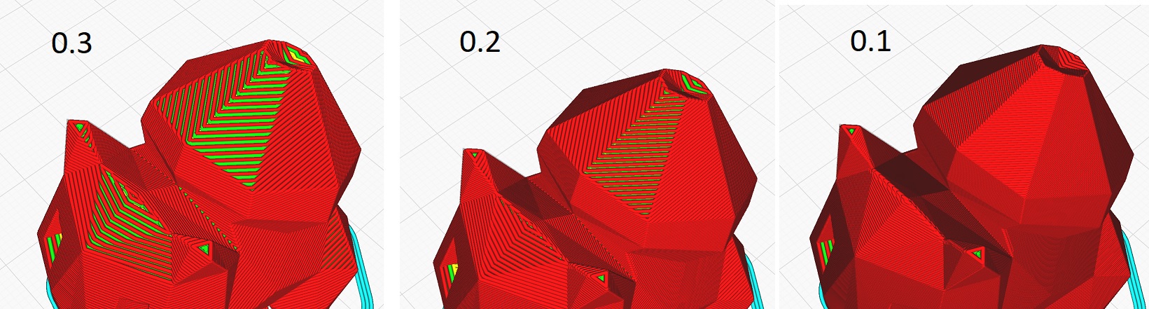

Had a similar problem recently. Found that when a surface has a very low angle then the layer height has quite a big impact on the surface finish.
Tried to slice a low poly model with different layer heights:
When printed the 0.1mm layer height model (right) did look pretty fine whereas the 0.3mm layer height model (left) had visible gaps:
Maybe you can give some information on your setting and maybe a link to the model then we can tinker around with it in order to see if we can reproduce your problems.

@Andomaster huh…interesting. My layer height is 0.12mm currently. I’m trying different layer heights right now to see if I notice a difference. And…there is. That seems to be the key. Although don’t think I can print this at 0.03mm to get the effect I want–at least it shows me what setting is I may have to change. I’d send the model link but it’s paid model and I don’t want to run the risk of breaking any rules about sharing something you need to buy. I’ve got a half globe thing here that I’ve replicated the same error.

  1. Layer width: I experienced Cura defaulting this to 0.4 for a 0.4 nozzle. Usually you want to get around 20%+ of your nozzle diameter, so for a standard nozzle it should be around 0.48. This way the unconnected top layer lines should cover a bigger area reducing the need for lower layer heights.
  2. Very thin layers could be problematic especially for the first layers depending on leveling accuracy. Once I read about a Cura feature called “adaptive layers”. This helps to vary layer height depending on the models details without sacrificing too much printing speed.
  3. Model orientation: when printing a shield I guess it’s possible to place the model perpendicular to the build plate. This way you change the detail limiting factor from layer height to x-/y-accuracy (while increasing printing time).
What you’re seeing is more or less to be expected. When your slicer is generating the gcode it creates a path that fits inside your shape. With a very small slope, going up one layer will result in a proportionally large flat area. So it will always look, by lack of better wording, “layered”. You could argue that the slicer should take this into account, but it has conflicting requirements with wall thickness etc.
One way to improve this a little bit is by increasing the top thickness of your print. At least with Luban this works. Because if the slope becomes small enough you create these horizontal terraces and by increasing the top thickness, these become a bit more robust. They will still be dull and rough, but at least stronger and you won’t as easily get gaps like in the Bulbasaur examples.
For a smoother finish you want to avoid small slopes on the horizontal layers. If you flip your model 90degrees so it becomes a small slope in a vertical plane. Then the shift sideways for the next layer becomes a lot smaller.
That’s why rotating the model before printing can help in that regard. Which obviously isn’t possible for all models and geometries.
