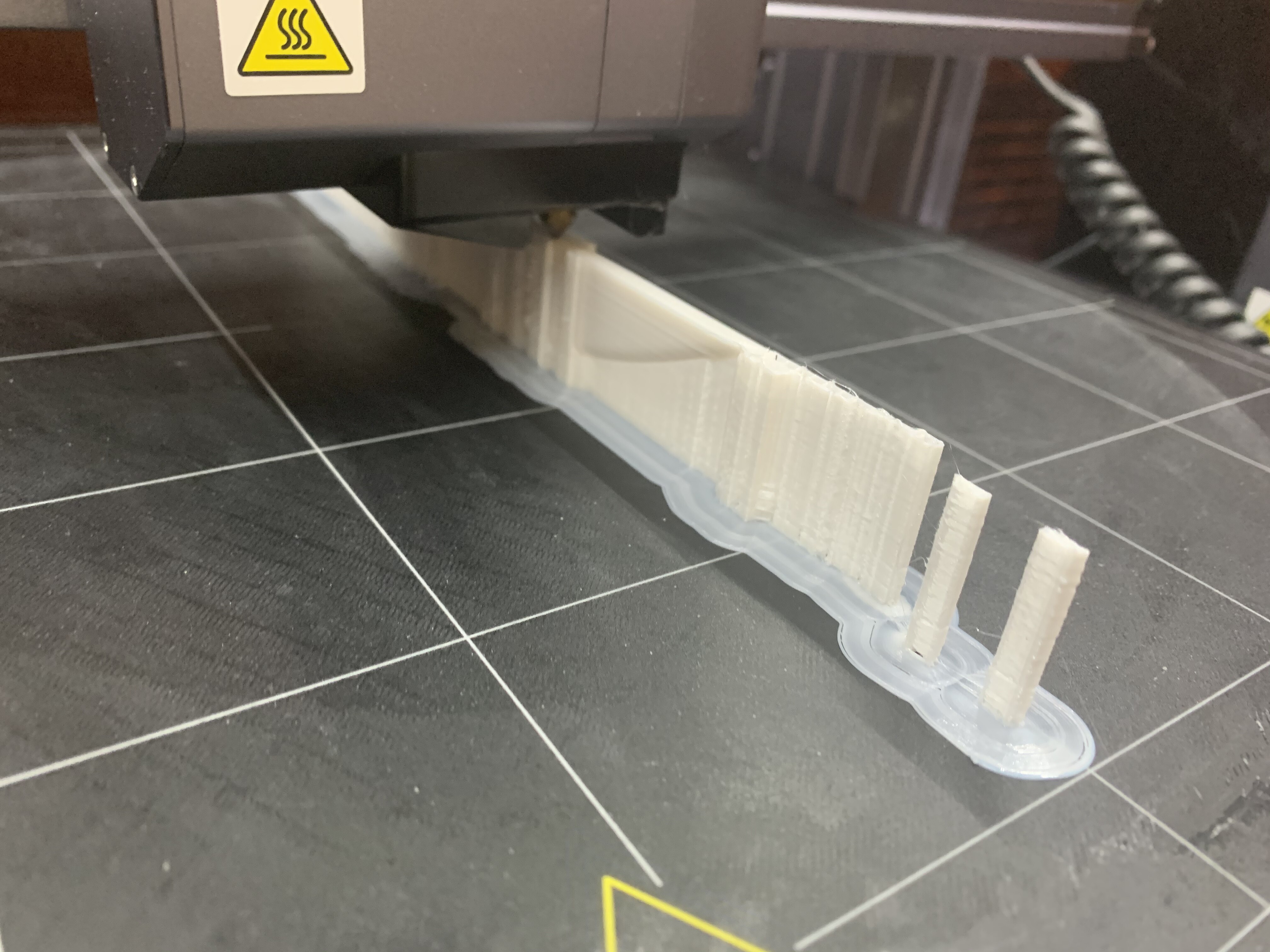

Re: Cura Support Line Width
I was printing from Cura, with default settings on Supports (15% density) with the only change being from ā€œZigZagā€ to ā€œGridā€ and the result was way, way, way too strong. Was printed using Premium PLA, aka PLA Plus. I had not made any changes to support distance. No signs of over extrusion.
Now, later, I’m printing again, and this time I made an edit to change the Support Line Width down to 0.3. (This option only shows up when an alternate Support Pattern, such as ā€œGridā€ (instead of ā€œZigZagā€) is enabled.)
I’m printing with it now, and the supports seem more like what they should be: stable enough to stand, but not so strong as to be unbreakable — as strong as a finished part should be.
See pics below of printing from Cura with 0.3 Support Line Width.
I had always understood that Grid gave too strong a bond if printed in the same material as the model and was mainly intended for dissolvable support like PVA on dual nozzle machines. There is a fairly interesting summary of Cura support options, don’t know if if you are seen it. Seems like way to many options for me to get my head round.
Pleased you have got a setting that works for you.
