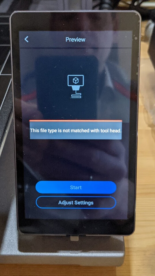

using the settings mentioned here, but unfortunately getting an error when sending the files from Cura to SN #2 350. Sending though wifi from Cura I get this error:
these are the settings I use or the machine in Cura
Saving the g-code and then importing to SN and then sending through Wifi to the SN works fine…
File types are generally implemented using the file extension. I don’t know what cura sends as the file name, but that’s a great place to start.

Check your gantry hight (should be 330, it is 30 on your screenshot)
indeed. thanks. will change that. though I have seen many different Gantry hights here on the forum. Not some much how high the gantry goes, but the size of the gantry itself. any idea what this metric refers to?
Have a look at this and or search the forum about gantry height :wink:
so had a look online, and indeed the Gantry height is 26, not 330 as you mention. The Gantry height is the clearance between the bottom of the nozzle and the bottom of the horizontal extruder rail. See point of xchrisd here above

Did you mean you’re sending from Luban? One can slice in Cura, save the g-code file, open the g-code file in Luban, and send via wifi to printer from Luban. If that’s not what you meant, then I’m curious what you are doing instead. ??
sending through Cura, and it actually works. Don’t open Luban at all anymore.

Did you solve your file issue? I saw mentions about gantry height, but could not tell if that was your solution or simply related talk.
gantry height was indeed solved:
Not tested runout sensor and power recovery yet.
File issue is now solved with the new route of sending to SM with Cura in the above
