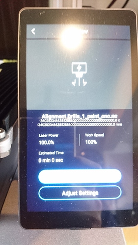

I’m currently working to make PCB with laser engraving + chemical etching.
To do this, I’m using FlatCAM to generate laser engraving G-code from gerber data.
The G-code worked well before upgrading to firmware V1.7.1.1 yesterday.
After upgrading, the controller app hangs before starting engraving.
The UI of the app is responding and I can press “Pause” button, but after pressing the “Pause” button, the UI also hangs.
After some investigation, I found that G-code files without appropriate headers (section surrounded by “;Header Start” and “;Header End”, which SnapMaker Luban outputs when exporting G-Code) cause the controller app hang up.
Copying the headers from a G-code file generated by Luban to the head of the G-code file generated by FlatCAM solve the problem and engraving finishes successfully.
So, I doubt that the fix of comment parser in the V1.7.1.1 affects this problem.
Are there anyone who also crashed into this problem?

Many thanks to @xchrisd. Could you please send me the G-code file and I can check the Head Start and reproduce this issue. @ciniml Thank you in advance.
Hi @Edwin
I’ve uploaded G-code files.
bad_with_flatcnc_comment.nc (111.4 KB)
bad_without_flatcnc_comment.nc (110.8 KB)
good_with_luban_comment.nc (141.1 KB)
First 2 files fail to engrave and controller hangs.
The last file has headers copied from another G-code file generated by Luban, and I’ve confirmed that my SnapMaker 2.0 A250 with firmware V1.7.1.1 can engrave with the last file successfully.
When “bad_without_flatcnc_comment.nc” is opened from Files app, the work area value is invalid (± max 64bit floating point ?).

Has anyone resolved this issue yet?
I just started using flatcam to try and drill holes for my PCB but the controller crashes when I try to do “Run Boundaries”
I have tried different firmware including the latest one and it does not seem to work.
It’s been a while since I used flatcam, but never have gotten the run boundaries working. In general. just don’t run boundaries, the rest works :sweat_smile:
(I usually ran the job, or part of it, like the final outline about 5 cm above the workpiece to validate first)
:pensive:
Not really the answer I was hoping for …
But thanks for the reply :slightly_smiling_face:
btw … which firmware are you using?
Are you removing any lines from the original Gcode file?
I saw another video that recommends to remove all lines that are in the parentheses.
I don’t know for sure anymore which firmware version that was. (Currently I’m on the last version, but haven’t done anything with flatcam lately). I would guess it was the 1.8.x version.
I did remove all comments from the cnc files. However, I also did end up generating different files for different parts of the path and manually combined them in one file. But even with individual files without modifications, I never could get the run boundary working with flatcam generated files. I briefly did try to find out what caused it, but couldn’t get it to work.
It does work for jobs generated by Luban and Fusion 360.
