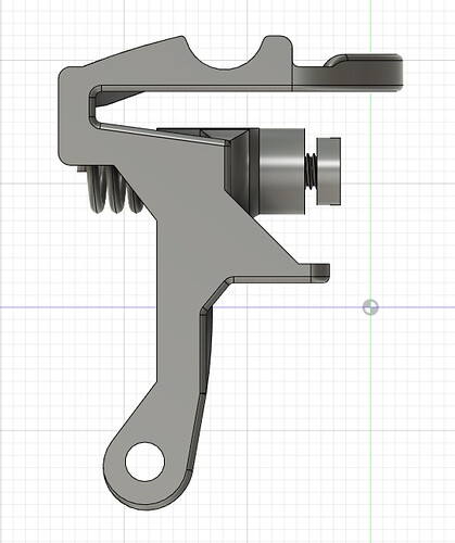

I had initially also thought that you have to find a solution for this and had designed a solution for this.
An adjustable filament guide.
It fits and works, however it was no longer necessary since we found a solution with a new heating bridge that works.

But if you are interested in an adjustable filament guide, I could possibly rework that.
