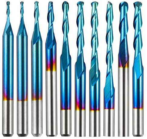

Finally found the exact match on amazon after finding something else close, shipping time is painful though: https://www.amazon.com/gp/product/B00R7B08GQ/ref=ppx_yo_dt_b_asin_title_o00_s00?ie=UTF8&psc=1

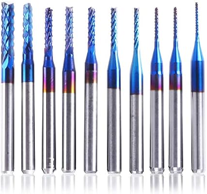

Also found these, which i went ahead and got b/c i think i can get away with 2mm: https://www.amazon.com/gp/product/B073TXC45Z/ref=ppx_yo_dt_b_asin_title_o01_s00?ie=UTF8&psc=1

Do you think this is a good substitute?
That’s an up-cut bit. The chips are pushed up during the cutting process. For a better surface finish, choose down-cut bits. They’re not as good at chip removal as up-cut bits, but they shear the surface downward during a cut, leaving a cleaner cut line.
