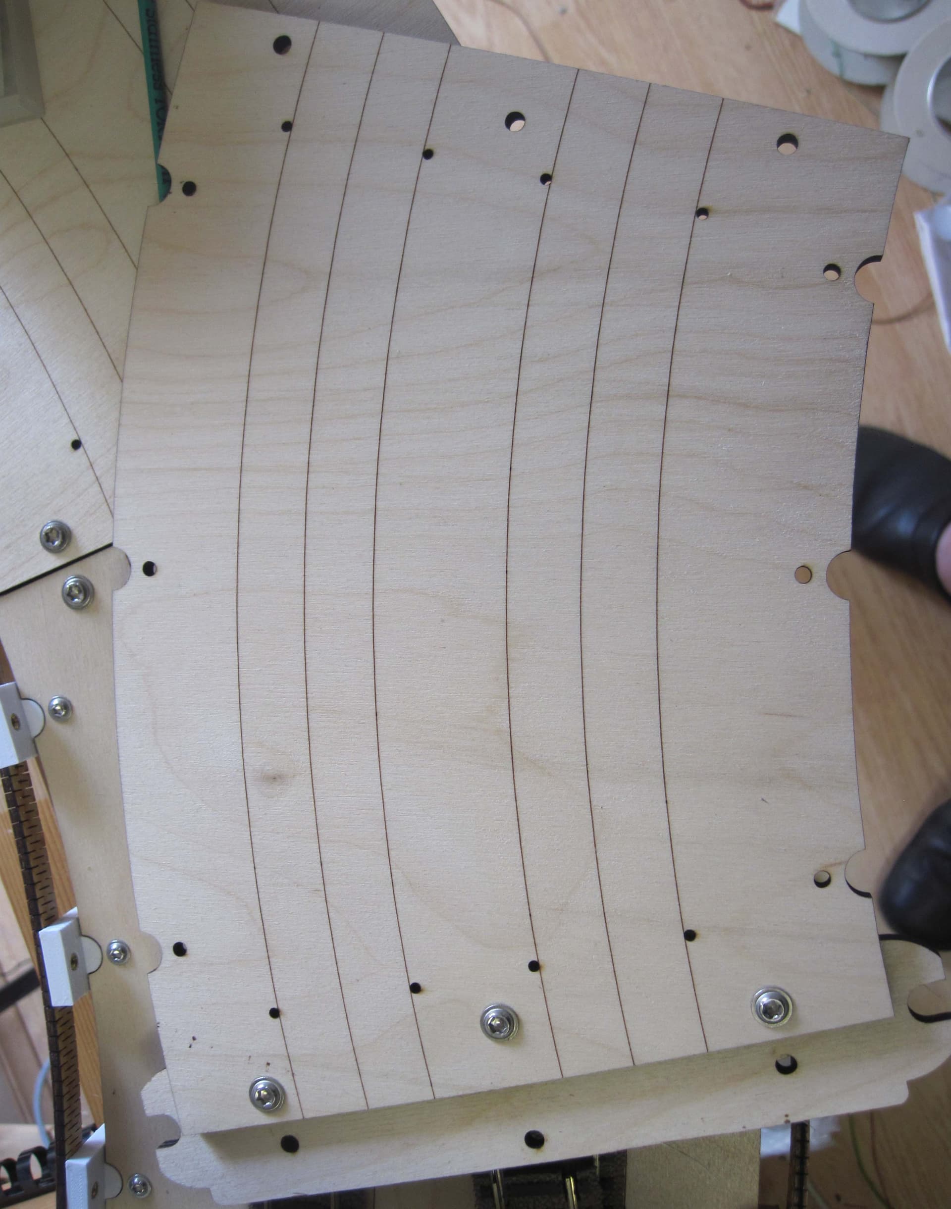

I know my zero point perfect. It is perfect on the left front corner. And always the same place.
I have cut > 50 pieces 6mm plywood for 2 630° helix and 1 180° for a H0 train. The wood pieces are 300mm x 200mm.
LightBurn screen
