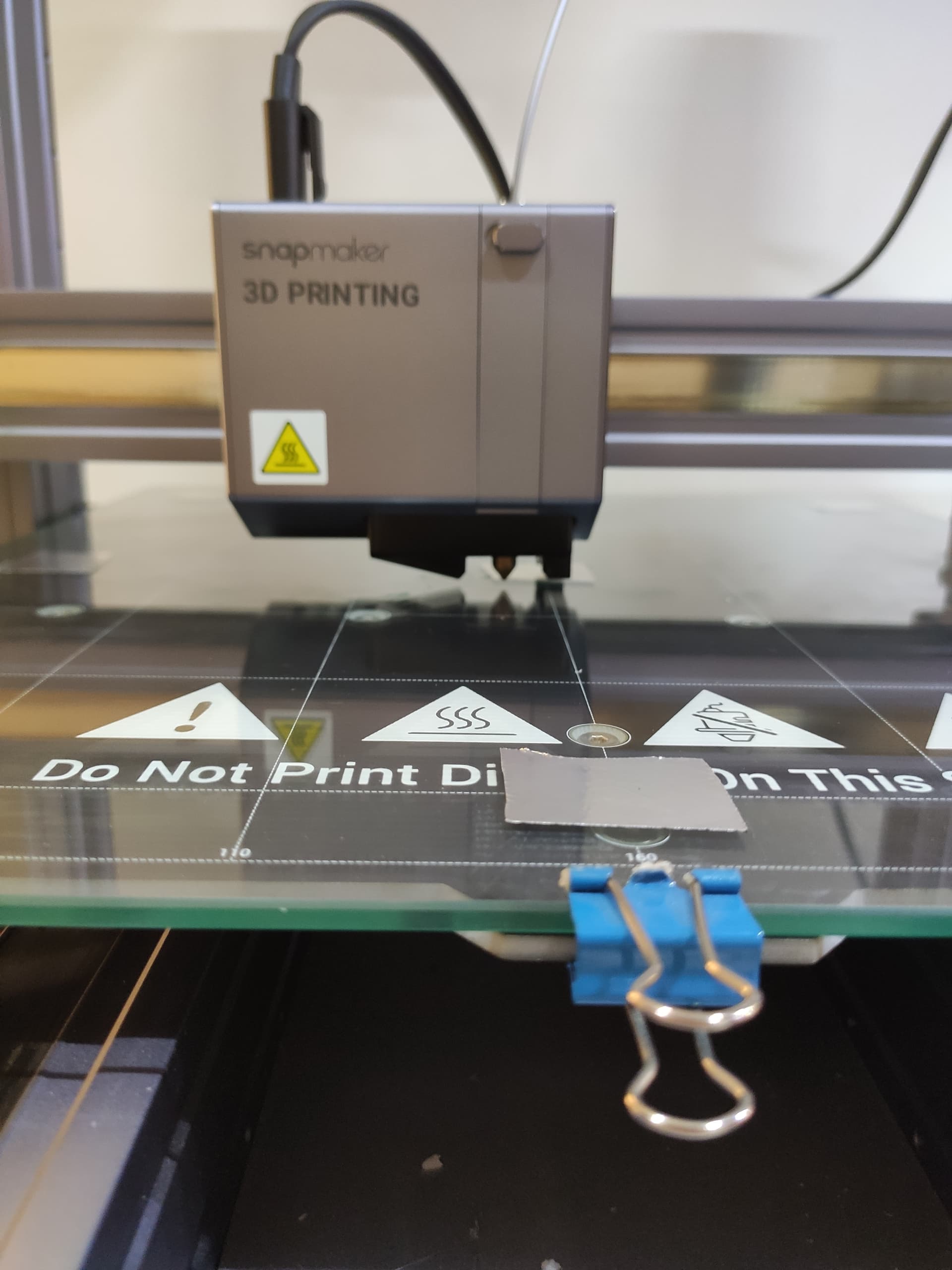

Today I cut a special glass 4mm according to the snapmaker table. When I put the glass on the heating plate and remove the heating plate and leave it directly on the chassis, it was easily noticed that it was crooked.
I made a workaround myself until Snapmaker made a comeback. I attached the glass plate to the heating plate with clamps. (Not touching the extruder) Later, I pulled aluminum tape to the places where the sensor came from. (You can see it in the picture. Before sticking, I brought the pieces of tape closer to the sensor and checked whether the light was on.)
I did not have any problems with the calibration. It prints fine now. (I didn’t have my hairspray at hand, so I directly pressed on the glass. Of course, there were minor adhesion problems.)
