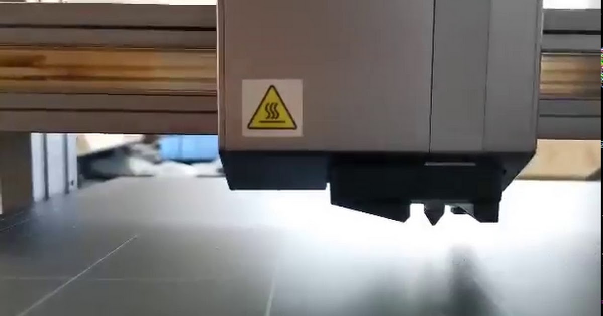

Switch the two converters of z and y to see if the behavior is the same, after that I would guess you have crossed the cable of y and z.
I haven’t been able to do anything with it. It took about a month of back and forth then finally able to do a live chat received and installed the new controller.
The Z axis port was not moving when plugged in the correct converts. I will try to switch and see what happens.
Video about the first calibration steps, Y-axis should move first.
Streamable Video
@xchrisd OMG that worked. It is now on auto calibration. Now though, the head is a little more than 10mm away from the board. Is that normal during calibration?
Well, that appreared to fix itself. I manually did that after the auto calibration. I cannot express enough how much I appreciate your going out of the way to assist this novice. I appreciate your time.

So if I’m understanding correctly, one of the converters just didn’t want to work with one of the axis and went false but works for the other
I know what magic is transpiring from that last thing but, it’s working! The first print I’ve ever done since owning this beauty. I don’t know what I didn’t pay attention to and was on automatic. The problens since March. I appreciate off of the assistance you two

I might have posted this video in the forum, but I am going to post it here again.
Please pay attention to the movement order of those linear modules.
HOME position: Z up → X left end → Y moves back, this is the HOME position.
If users mix up the cords, the movement order will mess up as well.
