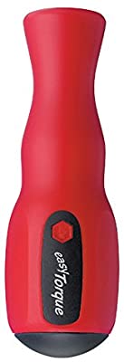

This sounds like an ideal situation for a dedicated-to-the-machine tool. By way of illustration, this is a torque-wrench handle, non-adjustable fixed at 2.5 N m (22.1 in-lbs). It would need a separate nut driver head for the nozzle itself. Wiha is high-quality and you pay for it. There might be something cheaper that’s adequate; I didn’t look.
Amazon has this for 10 bucks.
However, pretty sure its not legit wiha. the listing says wiha. judging by the picture its probably a knockoff

Is there a spec someplace that says the snapmaker nozzle wrench is 2.1 nm or is that number based on the prusa information and not necessarily going to apply on this machine?
2.1 was just based on prusa - I’m sure 1.5 would be fine. I’m also quite sure that a well calibrated hand can do just fine with a normal wrench, I’ve never torqued one with a tool. Tighten til it loosens, and then back half a turn :wink:
