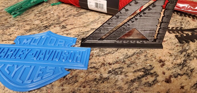

My blue spool leaves clumps of blue and strings everywhere, I have done lots of research on different types. I will be trying next brand soon. Dehydrating is not an issue where I live always hot and dry, but I do have a system and Dehydrated my blue and black before I even used them as I read so many bad comments on them.
See the clips I knocked off the side.
Compared to black on fast print
Needless to say, I printed 5 speed squares in black 60 hour print. File saved to device. My home internet went down for 10 min and I ended up with 5 of these right at the end.
What is the blue spool exactly? brand and type?
The snapmaker one.
okay. this is opinion, and not intended to be condescending
i think that you just happen to be getting decent prints on the bad spool due to default settings (in the box spools are bad and snapmaker replaced suppliers) and may not even realize some of the issues it has, while the blue spool comes from their new supplier and is a little better in quality but the settings are not optimized.
