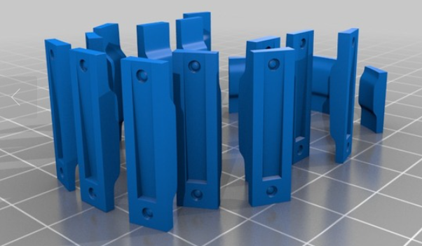

These are going to be challenging as well
Screen Shot 2022-02-02 at 9.26.29 AM
You’ll need a brim or raft, and possibly zhop. Tall narrow parts are just asking to get knocked over by the print head. And a smaller layer height means there is less clearance for the print head to avoid impacting the part. I’ve had several parts I can print fine at 0.2mm, but just cannot print (even with zhop) at 0.04mm. (Well, I’m sure I could print it… but failing 30 hours into a 50 hour print gets annoying pretty quickly…)
Actually those printed without any issues or a brim. All of that model printed easily bar the smaller eye part. I’ll run that print again tomorrow while at work nearby and have a play with settings/supports to see if I can succeed.
I can imagine. I have kept my prints to under 10 hours total as the ear bending from the missus if she hears the printer at night (she could hear a sparrow pass wind 2 miles away :stuck_out_tongue: )
Wow, really? In that vertical orientation? That’s a very difficult part to print, I’m amazed.
That does narrow down the possibilities of issues you’re having because those would require pretty close to perfect tuning to print without a brim, vertical, with no issues.
